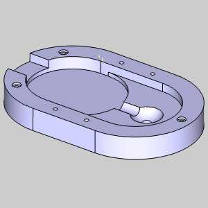

Create a Mill 2 Axis Feature

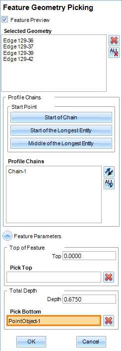

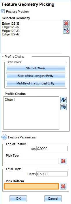

Feature Geometry Picking

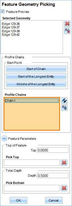

  1. Click Select Geometry.

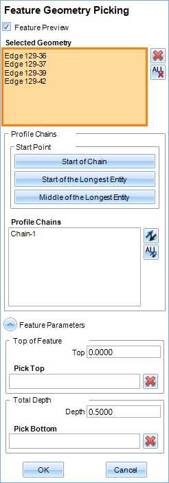

    The Feature Geometry Picking dialog appears. Focus is automatically placed on the Selected Geometry list allowing you to choose the feature geometry from the graphics area.

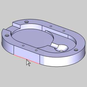

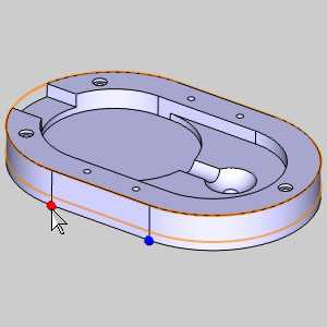

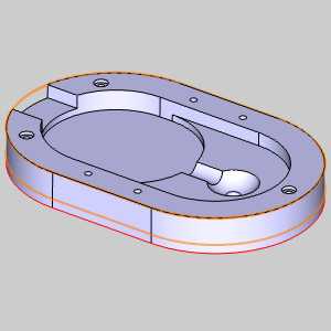

  2. In the graphics area, select the bottom edge of the part.
    The geometry is added to the Selected Geometry list, and the feature preview is visible.

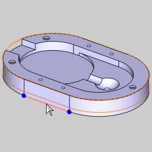

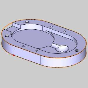

  3. In the Profile Chains list of the Feature Geometry Picking dialog, click Chain-1.
    The chain direction is displayed in the graphics area.
    We will leave our chain in its counter clockwise direction for now.
  4. At the bottom of the Feature Geometry Picking dialog, click in the Pick Bottom list.
    The list is given focus.
  5. In the graphics area, click the bottom edge of the model.
    The snap point is added to the Pick Bottom list, and the Depth is updated.
Note: Clicking the actual snap point that appears is not necessary. When you select an edge to pick a point, the closest snap point is always used.
  1. Click OK.

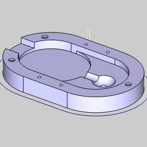

  4. In the Lead-in group, select Circular.
  5. In the Arc group, set the Radius to 0.3000.

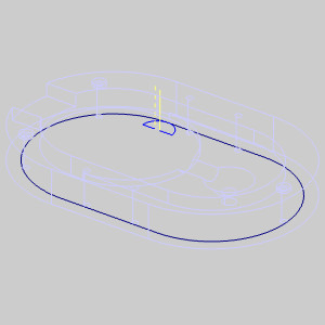

  6. Click Compute.
    The toolpath is created.

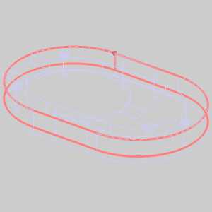

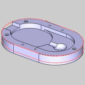

By default, Left System Compensation is used. With the default counter clockwise direction, this puts us on the wrong side of the selected geometry.
  1. In the CAM Tree, right-click Feature 2 Axis and select Edit.
    The Mill 2 Axis Wizard returns.
  2. In the tree on the left side of the wizard, click Patterns to open the Patterns page.
  3. In the Compensation group, change System Compensation to Right.
  4. In the Compensation group, change Machine Compensation to Comp Right / G42.
  5. Click Compute.
    The toolpath is updated. With the counter clockwise direction of our chain, we are now using a conventional cut.

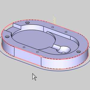

Updating Chain direction
  1. In the CAM Tree, right-click the Geometry item in our Feature 2 Axis, and select Re/Select.
    The Feature Geometry Picking dialog opens.

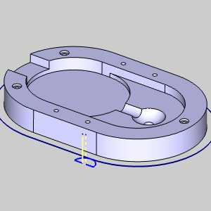

  2. In the Profile Chains list, click Chain-1.
    The chain is displayed in the graphics area.
  3. Click the closer side of the part.
    The chain start point moves to the closes snap point.
    Our direction is still counter clockwise.
  4. Click the same area.
    The chain reverses direction. Computing the feature now, would place the toolpath inside the part again. To avoid this, we will change our compensation again.

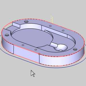

Updating Compensation
  3. In the Compensation group, change System Compensation back to Left.
  4. In the Compensation group, change Machine Compensation to Comp Left / G41.
  5. Click Compute.
    The toolpath is updated. With the clockwise direction of our chain, we are now using a climb cut.
