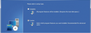

3. Next, you will need to choose Custom or Complete Installation. To install just the Server Utility, select Custom.
Pic. 1 Choosing the Setup Type

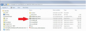

7. Once the install is finished, you will need to launch the server utility from the location it was installed on from Step 5.
Pic. 3 Opening the License Server

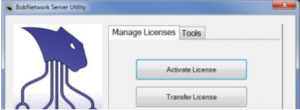

8. Once in the License Server Folder, click on Bobnetwork_server to launch the server utility.
Pic. 4 Opening the License Server
9. Under Manage license, click on Activate License.

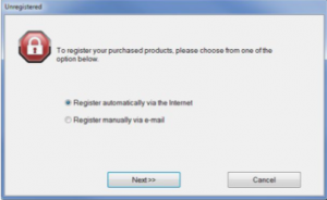

10. Next, choose the option that corresponds to if you have internet or not, and click Next.
Pic. 6 Activating the Network License
11. For internet activation: Input your license ID and password then click Next.

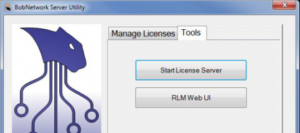

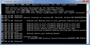

13. You should receive an activation success message at this point. Next, click on Tools, then select Start License Server.
Pic. 7 Starting the License Server
14. This will launch the server utility. After this, you can install and register the software on the client computer.
Pic. 8 Starting the License Server
