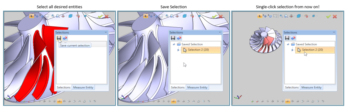

The new Selection Manager allows you to select any number of entities and save them as a single selectable item so that you can select every one of them with a single click in the future. With each new version, BobCAD-CAM gets easier and easier to use, but no matter how easy, geometry selection can still take time. When many entities need to be selected, zooming, rotating, and panning the model to select the required geometry takes time. With the new Selection Manager though, there's no reason to spend a lot of time selecting the same geometry twice, ever! Simply pick your geometry and save your geometry as a Selection. Next time the same geometry needs to be selected, just give it a quick click in the Selection Manager and it’s all selected at once!
