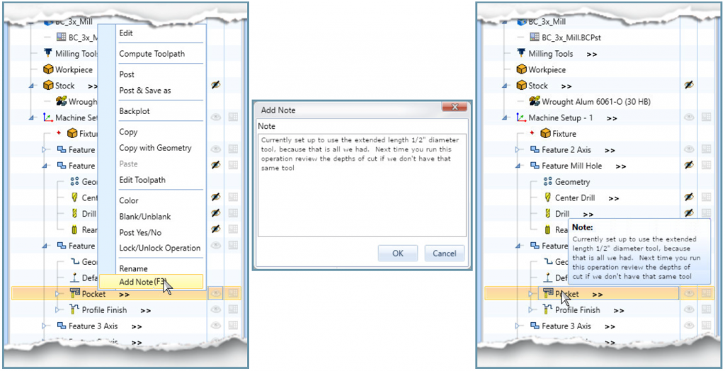

The CAM Tree Add Notes Feature
The new Add Note option allows you to create your own custom tool tips for items in your CAM Tree! Tool tips can be found everywhere in software and are a great way to get a quick explanation of a functions purpose. Simply hover your mouse over the function and a note pops up. In the new BobCAD-CAM V34 we found a way to help you organize your job even more by giving you a way to create your very own tool tips. Simply right-click the item and choose Add Note. The Add Note dialog appears allowing you to type a message out. Click OK, and a Note icon is added to the item in your CAM Tree. The next time you, or another programmer hovers over that icon, the tool tip appears! Notes can be added to:
  • Job
  • Machine Setup
  • Feature
  • Operation
  • Index Systems
  • Groups
