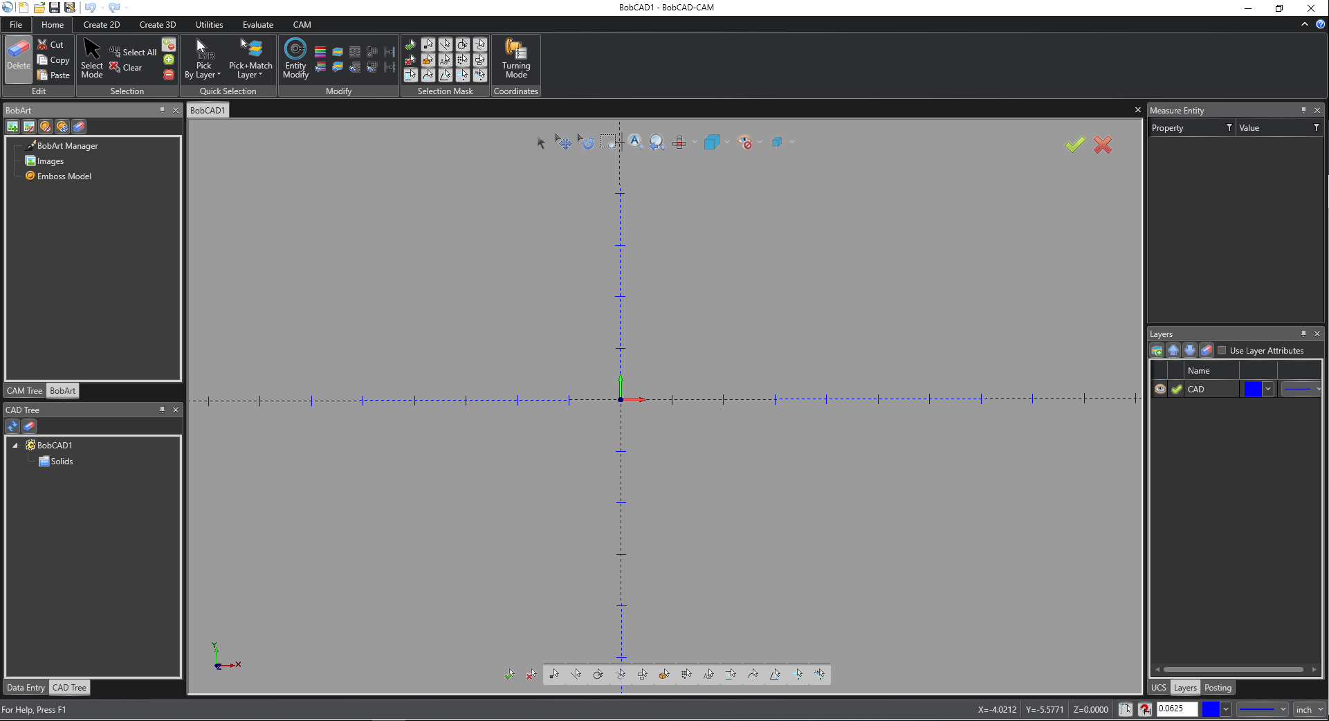

Pic. 1 – Initial User Interface Data Entry, CAD Tree, BobArt & CAM Tree shown on left. Measure Entity, Layers, UCS & Posting shown on the right.
Pic. 1 shows the initial User Interface setup for this example. This is the Profile Layout named ”After Dark”.

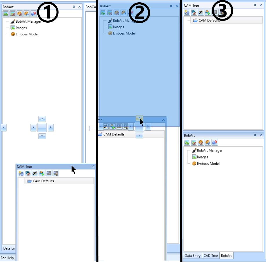

Pic. 3 – Placing window in different location
While holding the window, there will be arrows and a square that will appear to drop the window in a location (Image 1), based on where your cursor is located. If you hold the cursor over one of the arrows or square, it will show a preview (highlighted blue) of where it will place the window (Image 2).
2. Drag the cursor over one of the arrows or the square to see a preview of where the window will be placed.
3. Drop the window on an arrow or square to mount it into the software. (If you drop the window outside of one of these entities, the window will stay in the position of your cursor and will not be mounted into the user interface of BobCAD.)

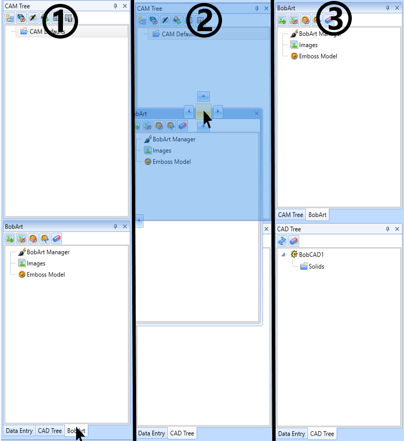

Pic. 4 – Placing another window into the upper left location
4. Grab another window and drag it to the upper left corner of the software until the arrows show up
5. Drop the window into the square icon to place a second window in the upper left section.
Notice how there are now two windows; CAM Tree & BobArt, in the upper left location and two windows; Data Entry & CAD Tree, in the lower left location.

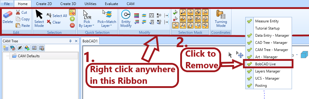

Pic. 5 – Hide/Unhide Windows
6. Right click anywhere in the top ribbon of the software to pull up the list of all windows.
If you want to hide or show a window, you can do this toggling on and off the checkmarks shown.
7. For this example, click on β€œBobCAD Live” to hide it

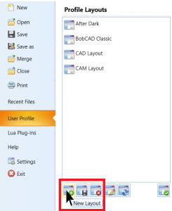

Pic. 6 – Saving the Current Customized Layout (Picture from V33)
8. To save the change made, Go to File --> User Profile
9. Click the (New Layout) icon to create the layout for the current changes

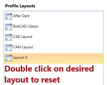

Pic. 7 – Reset layout
If you ever want to reset your layout. Just double click on the desired Layout to reload it. DO NOT hit the apply button to reset the layout which is used only for the User Interface Options below.

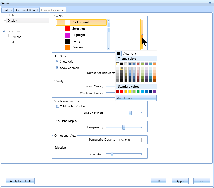

Pic. 8 – Changing the Background Color of Graphics Area
10. Go to File --> Settings
11. Click on the β€œCurrent Document” tab
12. On the Display tab, select Background and click the on the side drop-down arrow to show the color list
13. Select a Background Color that you would like to make your Graphics Area
While you are on this page, you can also adjust other colors as well such as the Selection, Highlight, Entity, Preview, Solids, Dimension/Text, Axis, UCS Plane and Toolpath colors.

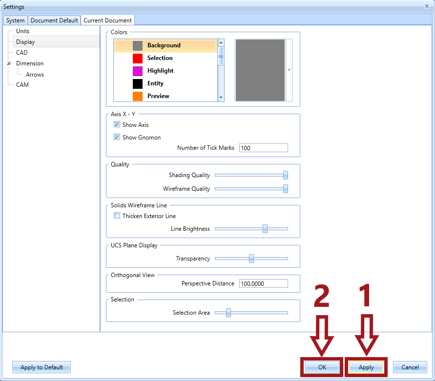

Pic. 9 – Apply the Settings Change
14. Select Apply then OK

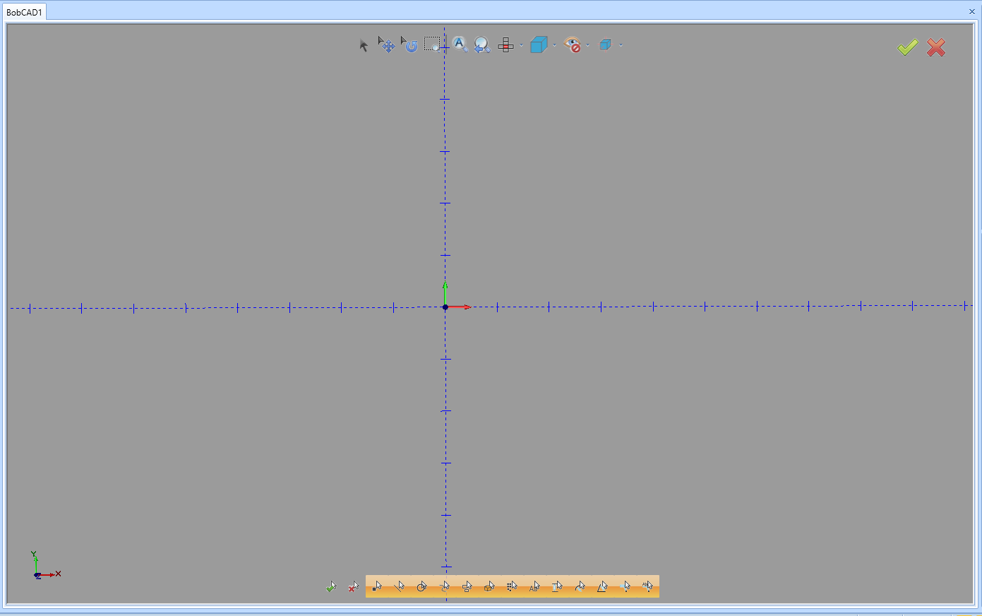

Pic. 10 – Background Color Change for Graphics Area
Pic. 10 shows the settings change applied for the background color in the Graphics Area.

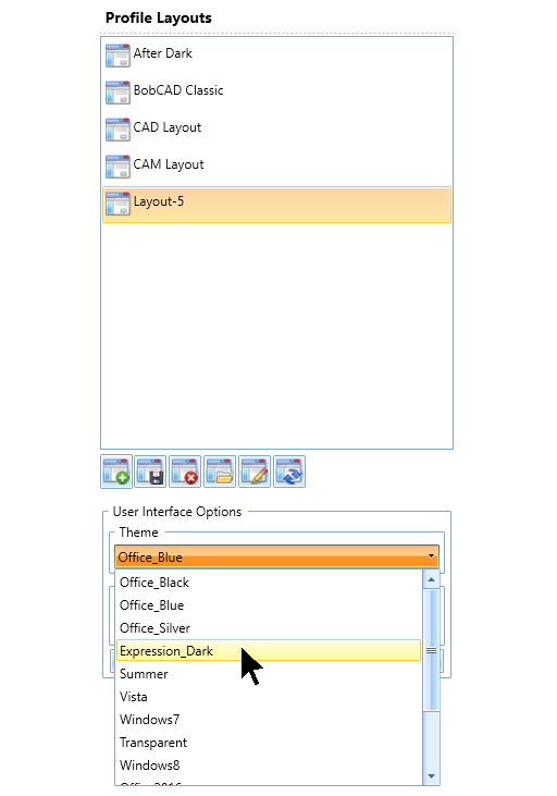

17.1 On the System tab in the User Interface section, click the drop-down box for Theme and select a different theme. (The theme selected for this example is Expression_Dark)
Pic. 11.2 – User Interface Options Theme V31-V33
16.2 Go to File --> User Profile
17.2 In the User Interface Options section, click the drop-down box for Theme and select a different theme. (The theme selected for this example is Expression_Dark)
18Β Hit Apply

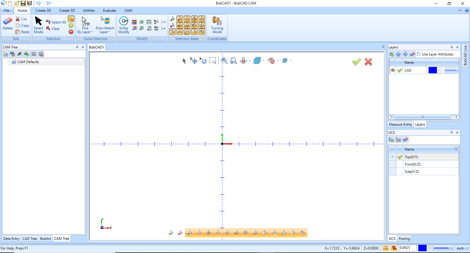

Pic. 12 – The Complete Customized User Interface Setup
Pic. 12, shows the completed User Interface after all changes have been made.
