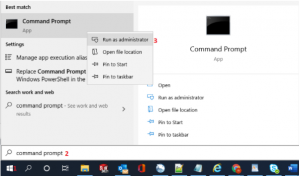

1. After installing and running the Network License on the server. Click on the Windows icon at the bottom left corner of the computer.
2. Type in “Command Prompt” and a search bar will automatically popup.
3. Right click on the command prompt and select "Run as Administrator".
Pic. 1 Running the Command Prompt in Admin Mode

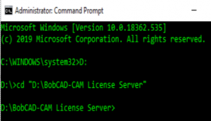

4. Enter: cd "c:\BobCAD-CAM License Server"
If it’s not in the C: first enter the drive (ie. D: ) then on the next line enter the folder cd “D:/…..”
Pic. 2 Going to the License Server in the Command Prompt

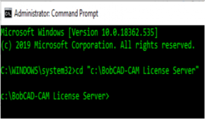

5. Enter: rlm -install_service -service_name "BobNetwork Server" -dlog "c:\BobCAD-CAM License Server\BobNetwork.log" -c "c:\BobCAD-CAM License Server\Licenses"
This will add BobNetwork Server to the services list in windows.
Pic. 3 Adding BobNetwork Server to the Services List

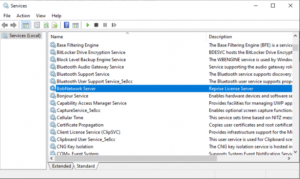

6. Click on the Windows icon at the bottom left corner of the computer.
7. Type in “Services” and a search bar will automatically popup.
8. Open the Windows “Services” Application
9. Locate ‘BobNetwork Server’.
Pic. 4 Opening the License Server

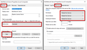

10. Right click on it and go to ‘Properties’ and set the following:
                a. Go to the recovery tab and change all scenarios to ‘Restart the Service’
                b. Change Startup Type to ‘Automatic’
                c. Click ‘Start’
Pic. 5 Starting the Network Service
