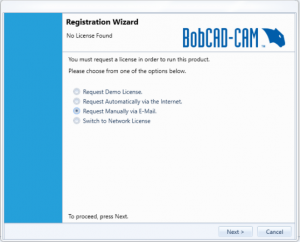

2. If the software is not registered, the Registration Wizard will appear. Select “Request Manually via E-Mail.” and hit Next
Alternatively, you can open the Registration Wizard by going to File --> Help --> Activate License

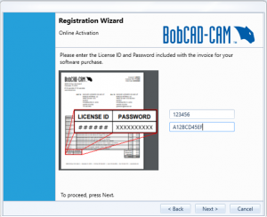

3. Type in your license ID and Password, Hit Next
Note: The password is case sensitive and should have no spaces. This information will be listed on your Invoice

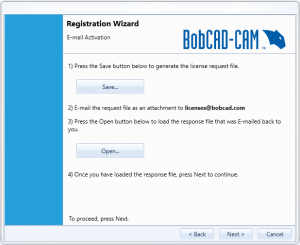

4. Click Save to save the license file on your computer
5. Send an email to [email protected] and await a response email back
Note: The automated response email may take same time to come in depending on the amount traffic.
6. Download the license file from the response email

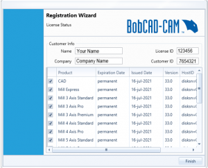

7. Navigate back to the Registration Wizard and Open” the license file
8. Click Next
