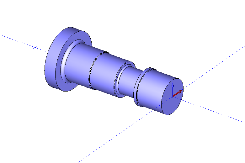

The lathe side of the software currently does not have the ability to move the machine setup to a specific location and so the user is required to orient all lathe parts to a specific location. The directions below will teach the user how to correctly orient their lathe parts, so that they can get good G-code when programming their part.
Pic. 1 - Example Lathe Part in Isometric View

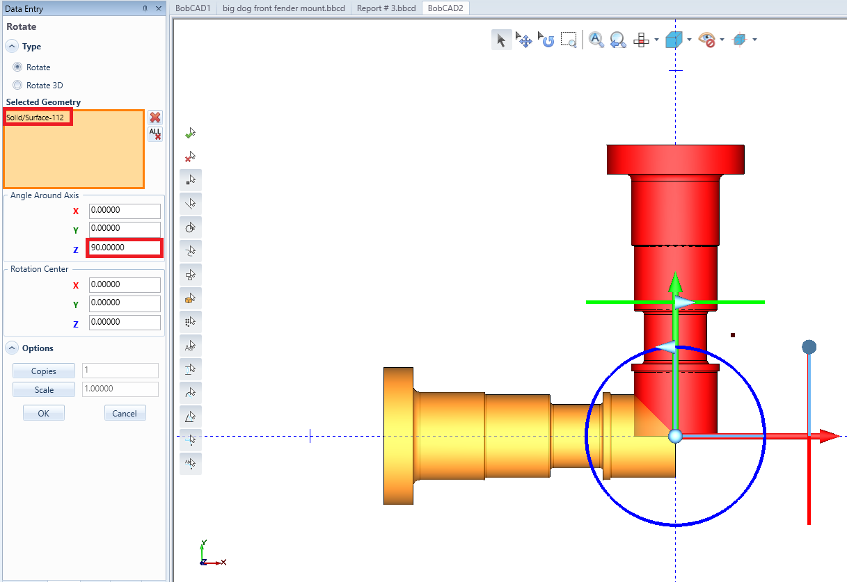

To rotate the part to the correct orientation, start up the rotation function by going to Utilities and clicking on Rotate. The first step when in the rotate function pops up is to select the geometry that is desire to be rotated. After selecting the geometry there will be red, green, and blue circles that will appear at the BobCAD origin. These circles show how the part rotates about the X-Axis (Red Circle), Y-Axis (Green Circle), and Z-Axis (Blue Circle). There are also arrows on each circle which will show the positive angle of rotation for each axis, once the correct value is known place the value in the โ€œAngle Around Axisโ€ of rotate function. In the example below, the part shown in red needs to be rotated in the +Z direction (Blue circle) by 90 degrees, after placing the correct value in the angle around axis a preview of the part will show up in orange to make sure that the rotate will be correct.
Pic. 4 - Rotating the Lathe Part to the Correct Orientation

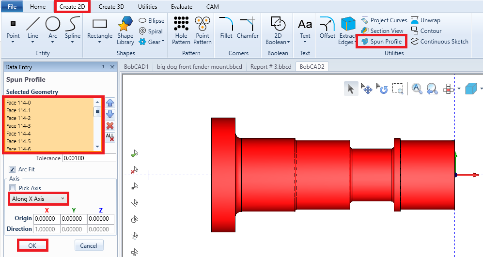

Alternatively, After rotating the solid to the correct orientation, the lathe side of the software requires the use of wireframe instead of a solid. To convert a lathe solid model into wire frame, the spun profile will need to be used which will basically un-revolve the solid into wireframe. To use the spun profile go to the Layers Manager and Right Click in the middle of the manager and hit โ€œAdd New Layerโ€ (this will help to differentiate between the solid and wireframe later on). Now go to the Create 2D tab, select Spun Profile, select the lathe solid, and lastly before hitting the OK button make sure that the axis that the spun profile is un-revolving about, is the X-Axis as shown in the picture below. After all of this make sure to right click on every layer except for the one that was just made and hit the blank button so that BobCAD will just leave just the spun profile in the CAD Space.
Pic. 5 - Performing a Spun Profile
