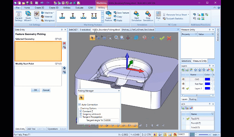

The picking manager is a new tool in BobCAD-CAM V36 designed to make it easier to select entities in the software. The new chain selection options give you an enormous amount of power to select entire chains, from wireframe and solids alike, with speed and ease! Whether you're selecting geometry for CAD features or assigning geometry to CAM features, these new options have you covered!
A computer screen shot of a blue object Description automatically generated

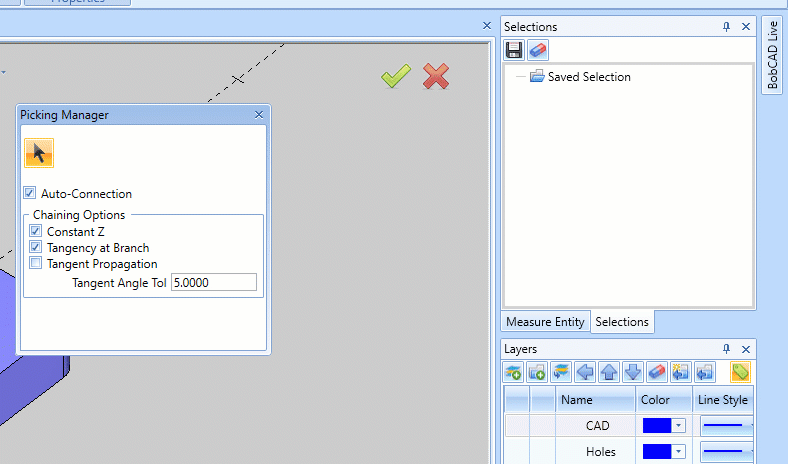

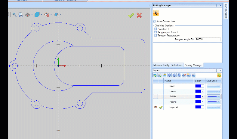

Pic 1 – Picking Manager Window
The picking manager is a window in the software that pops up whenever using anything that requires selecting geometry, like when picking geometry for a feature, or when using a CAD function like Translate to select entities to move.

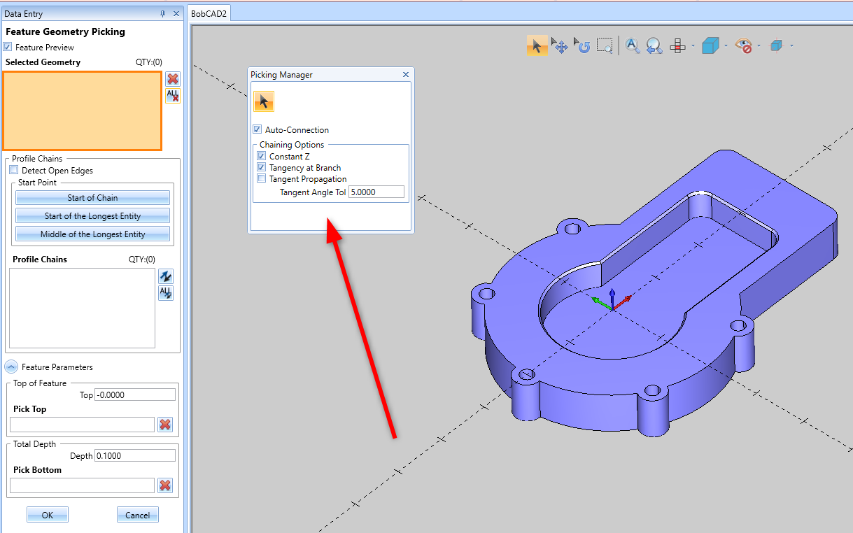

This Picking Manager window works just like the other windows (eg. Layers, CAM Tree) in the software. You can move and place it anywhere in the software. It will stay in the location you place it for any future selections.

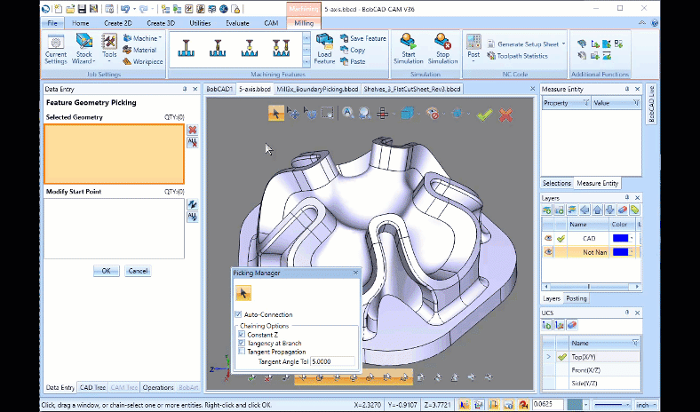

Hold Left-Click on the top of the Picking Manager window. You will see arrows pop up in the software where you can drag your cursor into to place the window. In the example below, we are dragging it into another window to move it to the desired location.
Pic 2 – Drag Picking Manager into another window
Next time the picking manager pops-up, it will show up in the location you moved it.

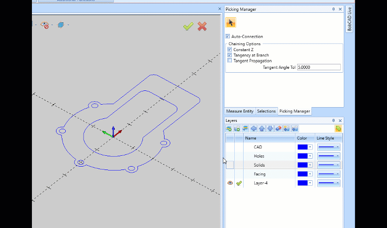

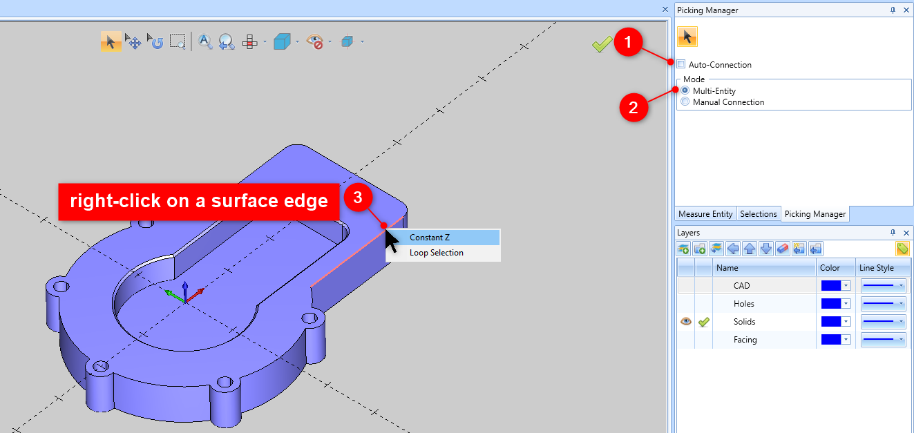

Old Picking Selection Method
If you are coming from an older version of the software that does not have this tool, you can still use the old selection picking method by unchecking, “Auto-Connection” and enable, “Multi-Entity”
A screenshot of a computer Description automatically generated
Pic 3 – Old Selection Picking Method
This will allow you to right-click on a surface edge and select “Loop Selection” or “Constant Z”. Or, Hold SHIFT + Left-Click on a wireframe to chain select your entities. You can also drag a box over the desired geometry to select entities. This was the old picking selection method.

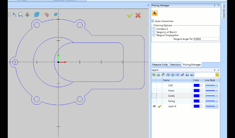

Auto-Connection:
However, to take advantage of this new tool, you can use the other options in the manager.
Let’s first cover the Auto-Connection page:
Pic 4 – Auto-Connection Picking Manager
The most common way to select geometry is by using the “Auto-Connection” page.

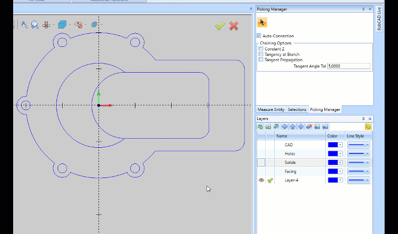

In this example, let’s keep the default options enabled on this page where “Constant Z” and “Tangency at Branch” are enabled. Now, simply click on the surface edge and observe how it chain-selects around the part automatically in one click.
Pic 5 – one click to chain select surface edge

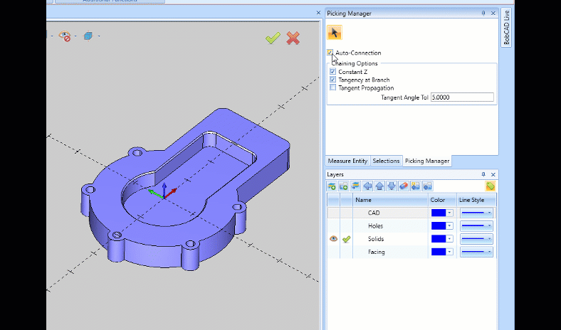

This works the same for wireframe geometry as well.
Pic 6 – one click to chain select for wireframe

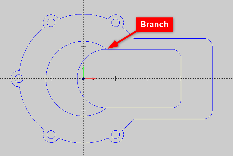

Tangency at a branch is an option that is used to decide how to pick a direction of the geometry selection if the software runs into a scenario where there is a "branch".

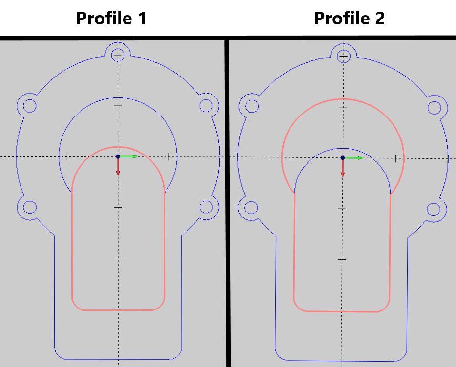

Take a look at the picture below. Typically, your geometry is either an open geometry, where the start and end point of the geometry are not connected, or, it is a closed geometry (similar to the outer profile in pic 8) meaning that there is no exact start and end to the profile. It is fully connected or "closed".
However, there is a third type of geometry that can also occur. In the image below, there can be cases where there are points in the geometry that split off in multiple directions. These intersections are called, “branches”.
A drawing of a circular object Description automatically generated
Pic 8 – example of branch geometry
In this example, there are two possible closed profile chains.
A graph of a profile and profile Description automatically generated
Pic 9 – two potential closed profile chains
So, how does the software pick which path that the selection travels down? This is where the “Tangency at Branch” and “Tangent Propagation” options come into play.
Let’s start by disabling all Chaining Options and see what happens.
Pic 10 – No tangency selected
In the gif above, notice how the selection stops at the Branch point location. The Tangency options are there to handle branching geometry. With all tangent options disabled, the selection will simply stop if it encounters a branch point.

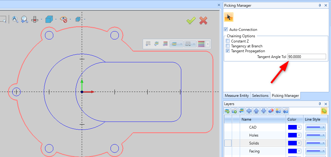

Let’s try to select the outer profile of the part with “Tangent Propagation” disabled and enabled.
Pic 12 - Tangent Propagation Example
With “Tangent Propagation” disabled, the picking manager does not pay attention to non-tangent areas in the profile. So, the whole profile is selected. However, with this option enabled, whenever the profile reaches a non-tangent location, the geometry selection stops there.
You can also set the amount of tangency that the manager will consider by setting up the “Tangent Angle Tol”. This is the degree at which you want to manager to by-pass Tangent Propagation and just continue the profile selection anyways. If we set this value to a high value like 90 degrees, notice in the picture below how it will select the whole profile again even when Tangent Propagation is turned on.
Pic 13 – Tangent Angle Tol
