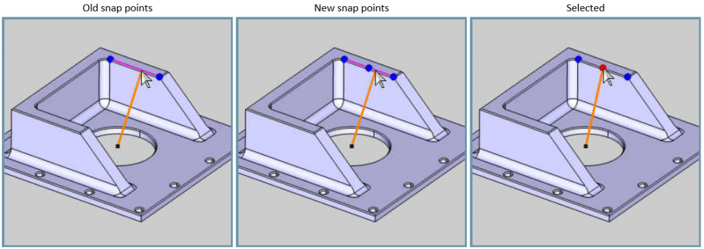

Here's a handy little extra that is available in the new V34: mid-point snap on surface edges! In the past, only the beginning and ends of the surface edge would provide snap points. This was perfect in most cases, but occasionally the mid-point would be needed. Without the snap point, you would need to do a little extra work to extract the edge from the surface and use the center of the resulting line. Now, with the mid-point available its easier than ever to snap geometry right where you need it.
