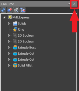

As shown in the picture below, there is a "X" button at the top right of every Window Pane. This button controls the visibility of this window. If you click this button, it will simply hide that window (It does not Cancel an ongoing function).

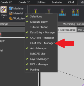

To view the visibility of these Windows, right-click anywhere in the top ribbon of the software (This shows a list of all 11 window panes and denotes by a green checkmark for ON and no checkmark for OFF). To turn a certain window back on, simply select the window in the list that is turned off (as shown in the picture below).

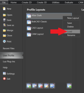

To Reset the Window Panes and get the missing windows back, Go to File > User Profile. Then, Right-click on one of the Profile LayoutsΒ that you like and select "Load" (See pic below).

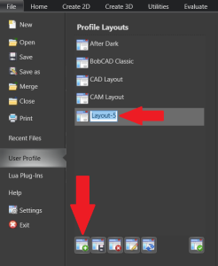

Note: You can save out custom layouts as well. To do this, setup the window panes inside of the software to your liking. When completed, go back to File > User Profile and click the Green Plus icon (located directly below the current "Profile Layouts"). Then, you can right-click on the new layout that got created and rename it (See pic below).
