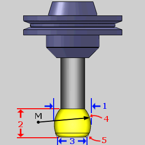

ClosedCorner-Round
When defining a corner rounding tool, the diameter must be greater than or equal to the small diameter plus twice the corner radius.
Diameter >= Small Diameter + (Corner Radius * 2)
If you enter values that do not fit this equation, an error message displays.
Tip: When defining a corner rounding tool, if the Diameter is greater than the current/default value, set the Diameter value first. This allows you to avoid receiving the error message. If the Diameter is less than the current/default value, set the Corner Radius first to avoid the error message.
  • Diameter(1)- sets the diameter of the tool.
  • Small Diameter (2) - sets the small diameter of the tool.
  • Corner Radius (3) - sets the corner radius size of the tool.
  • Small Diameter Length (4) - sets the size of the small diameter of the tool.
  • Shaft Diameter (5) - sets the diameter of the shaft.
  • Overall Length - set the total length of the tool.This value must be greater than the Protrusion Length.
  • Additional Information - lists any notes added by the user in the Additional Information field on creation.

ClosedBarrel Standard
  • Flute Length (2) - sets the cutting length.
  • Profile Radius (3) - sets the radius used as the side profile of the tool.
  • Corner Radius(4) - sets the radius used as the transition between the bottom and the Profile Radius of the tool.
  • Shaft Diameter(5) - sets the width of the tools shaft.
  • Overall Length- sets the overall length of the tool.

ClosedBarrel Double
  • Diameter (1) - sets the width of the tool shaft.
  • Profile Radius (3) - sets the radius applied to the cross section of the tool.
  • Corner Radius (4) - sets the radius used between the Lower Radius and the Profile Radius.
  • Lower Radius (5) - sets the radius used for the profile section of the tool tip.
  • Overall Length - sets the overall length of the tool.
  • Holder Label - displays the name of the associated tool holder.When blank, no tool holder is associated.

ClosedBarrel Section
  • Upper Corner Radius (4) - sets the radius applied between the Profile Radius and the shaft.
  • Lower Corner Radius (5) - sets the radius used for the profile section of the tool tip.
  • Shaft Diameter (6) - sets the width of the tools shaft.
  • Distance(M) Axial (7) - defines the center arc of the profile radius in height along the center of rotation.

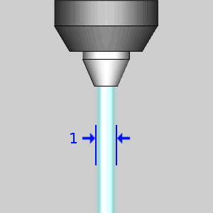

Tool Data
  • Diameter - sets the beam thickness.
  • Gas Type - sets gas output call as defined in post questions 762, 763, and 764.
Cutter
  • On - calls the cutter on code as defined in post question 752.
  • Off - calls the cutter off code as defined in post question 753.
Gas
  • On - calls the gas assist on code as defined in post question 760.
  • Off - calls the gas assist off code as defined in post question 761.
Shutter
  • Open - calls the shutter open code as defined in post question 765.
  • Close - calls the shutter close code as defined in post question 766.
ClosedFeeds and Speeds
Feeds and Speeds
  • Feedrate - Controls how fast the tool moves during cutting.
  • Pierce Dwell - Specifies how long to pause at the beginning of the cut.
  • Pulse Frequency - Determines how often the laser or plasma pulses during cutting.
  • Power Setting - Defines the output level used to generate the cut.
  • Torch Height Control - Adjusts the distance between the torch and the material surface.
  • Arc Slowdown % - Sets the amount of the feedrate to use when in arc moves. 100% is equal to the Cutting Feedrate.
