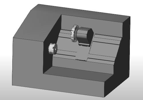

BC 1T 1S
This machine is a common mill turn configuration with a single turret (tool-holding device) and a single spindle (workpiece-holding device). This machine has 3-axis or XZC machining capabilities and a single submachine (work zone). The ability to mount live tooling to the turret is what separates this mill turn machine from a standard 2-axis lathe.

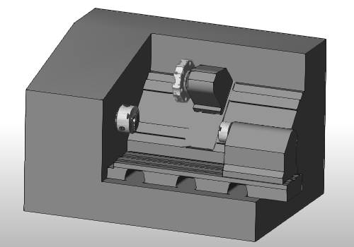

BC 1T 2S
Another common mill turn configuration uses a single turret and two spindles. This machine has 3-axis or XZC machining capabilities and two submachines (work zones). This machine configuration is beneficial because it includes a subspindle (with linear travel), so you can transfer the part from the main spindle to the subspindle to perform work on the back side of the part, helping to reduce setup time.

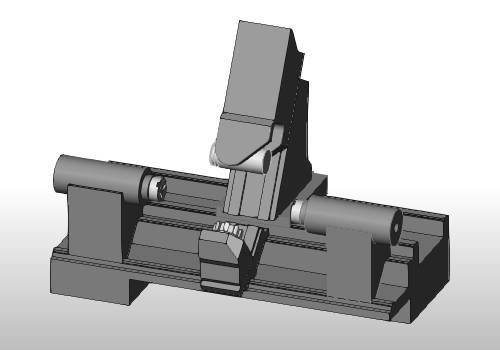

BC 1T 2S Y
Similar to the BC 1T2S, this machine uses a single turret, two spindles, and adds Y-axis machining capabilities that allow for more versatile milling that cannot be accomplished on machines without a Y-axis. This multiaxis machine has 4-axis or XYZC machining capabilities and two submachines (work zones).

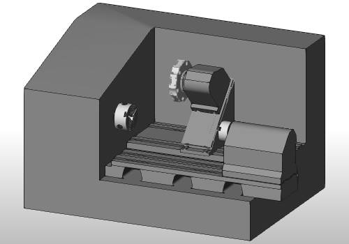

BC 2T 2S
This multiaxis mill turn configuration uses two turrets and two spindles and adds Y-axis machining capabilities to the upper turret only. This machine has 4-axis or XYZC machining capabilities and four submachines (work zones). This machine configuration is extremely versatile because you can mount tools to a second turret, and both turrets can work on either spindle.

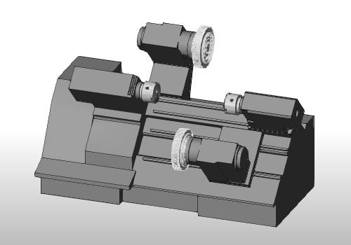

BC 2T 2S 5X
This multiaxis machine contains two tool-holding devices, one turret and one milling spindle/head, and two spindles. This machine allows for 5-axis or XYZBC machining capabilities with the addition of the milling spindle. This machine configuration is highly desirable for its multiaxis capabilities and four submachines (work zones).
