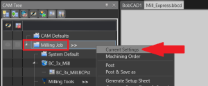

1. Navigate to the “CAM Tree” and right-click on “Milling Job”
2. Select Current Settings

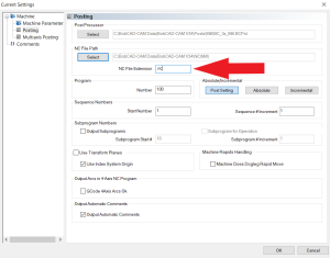

3. Inside the “Posting” tab on the left-hand column, you should find the “NC File Extension” box. Change the file extension to what your machine controller accepts. Click OK when done.
Note: Make sure to include a “.” before the text.
Note: If your machine does not accept a file extension (File type in "File Explorer" would just say, “file”), you will want to put a “.” Followed by a space (Example: “. ”) in the NC File Extension box inside of BobCAD.

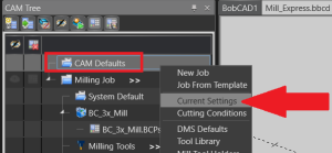

4. Navigate to the “CAM Tree” and right-click on “CAM Defaults”
5. Select Current Settings
6. Repeat Step 3 from previous section
