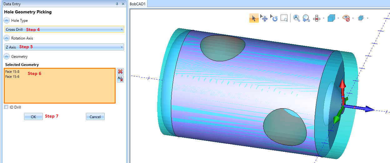

2. Right Click on the Machine Setup and under the Mill Features select the Mill Drill Hole Features
3. Now left click on the Select Geometry button
4. In the Hole Geometry Picking window callout “Cross Drill” in the Hole Type drop down box.
5. For the Rotation Axis, select the axis that you cross drill will be rotating about (Primarily the Z Axis for Mill Turn)
6. Next left click on the selected Geometry box and then select each of the cylindrical faces of the holes that are to be cross drilled.
7. Hit OK
Pic. 1 - Setting up the Hole Geometry Picking Window
A picture containing graphical user interface Description automatically generated

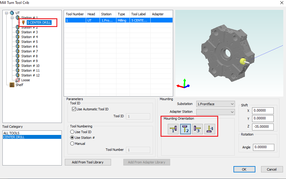

9. In the CAM Wizard’s Tooling page select the tool crib, this will bring up the tool as it sits in the Mill Turn’s turret.
10. Drag the Center drill, drill, etc. into the correct station that it will be machine.
11. For the Mounting Orientation of the tool, go ahead and change the mounting orientation to the number 2 to setup the tool in a cross-drilling orientation.
Pic. 3 - Setting up the Tooling Orientation
12. Perform Steps 9 through 11 for all tools in the cross-drilling feature.
