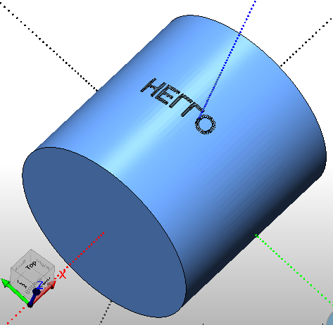

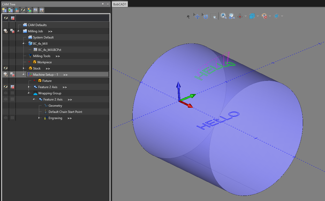

For example, let’s say that you programmed a wrapping group toolpath as you see in the image below.
A computer screen shot of a blue cylinder Description automatically generated
Pic 1 – Example Basic Mill 4-Axis Wrapping Group toolpath.

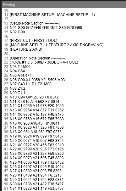

And, when you run the simulation, the toolpath looks to be correct as well. (See pic 2)
A blue cylinder with black text Description automatically generated
Pic 2 – Simulation

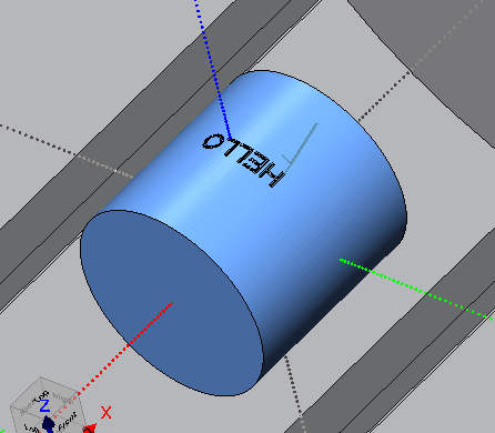

However, when you run the toolpath on your machine, the part comes out as a mirror image. Or, in other words, the rotary unit moves in the opposite direction than what you expected. (See pic 3)
Pic 3 – Mirror Image on the machine
This is the issue that this article is describing. The issue happens because the configuration in the BobCAD post processor is different than the way the machine was set up on the controller.

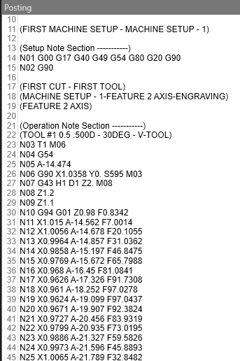

From the example above, the standard g-code output (Using the the BC_4x_Mill machine) is as follows:
A screenshot of a computer Description automatically generated
Pic 5 – Example G-Code output
Observe in pic 5 that the A rotary moves start in the positive direction.

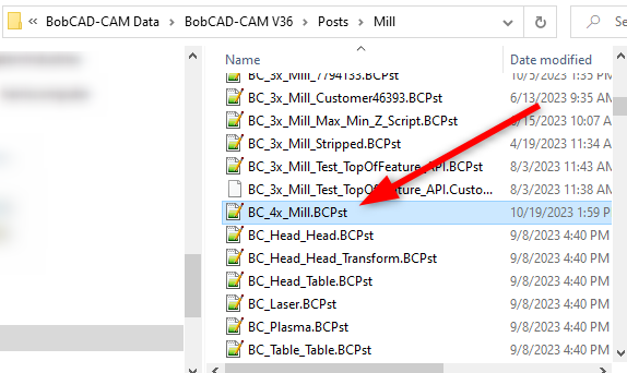

1. Open a “File Explorer” on your computer and navigate to this folder to find your post processor file: (Ending in .bcpst)
C:\BobCAD-CAM Data\BobCAD-CAM V36\Posts\Mill
Note: This is the default location. This could be different on your computer if you adjusted the posts directory location.
2. Find the name of your post processor and select it. A screenshot of a computer Description automatically generated

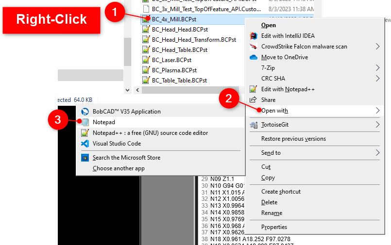

3. Right-click on the file > Select “Open With” > and open a text editor like “Notepad” on your computer.
Note: In this example, you can simply use “Notepad” to make the modifications. However, Notepad++ is recommended for doing small edits to the post processor if you want an easier way to make modifications. Navigate HERE to get set up with Notepad++ and our Post Processors

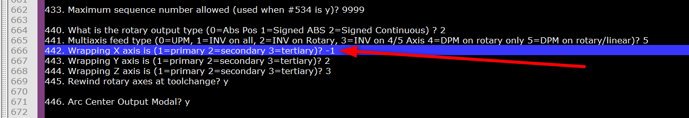

4. With the post processor now opened in Notepad, navigate to question 442. In the post processor. If you are modifying the X rotary move (Usually an A prefix), adjust 442. to -1
442. Wrapping X axis is (1=primary 2=secondary 3=tertiary)? -1
A screen shot of a computer Description automatically generated
5. Save the post processor file.
6. Once saved, simply post out the g-code program in BobCAD again and observe the change in the g-code. Notice in the image below that now our rotary moves are posting out negative (-) values to start with instead
This is how you can reverse the rotary direction inside of a post processor for BobCAD-CAM for a Mill 4-Axis machine.
Test this newly created g-code program out on your machine and see if this fixes your issue.
