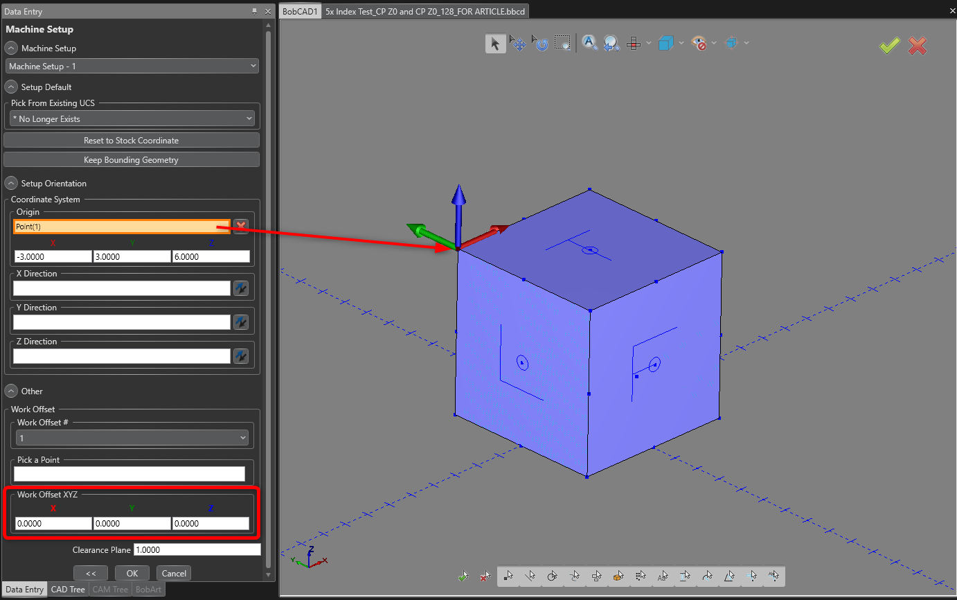

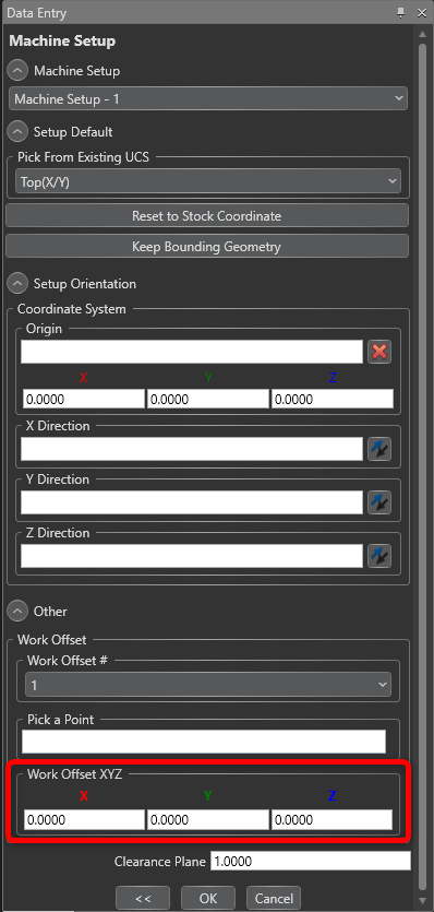

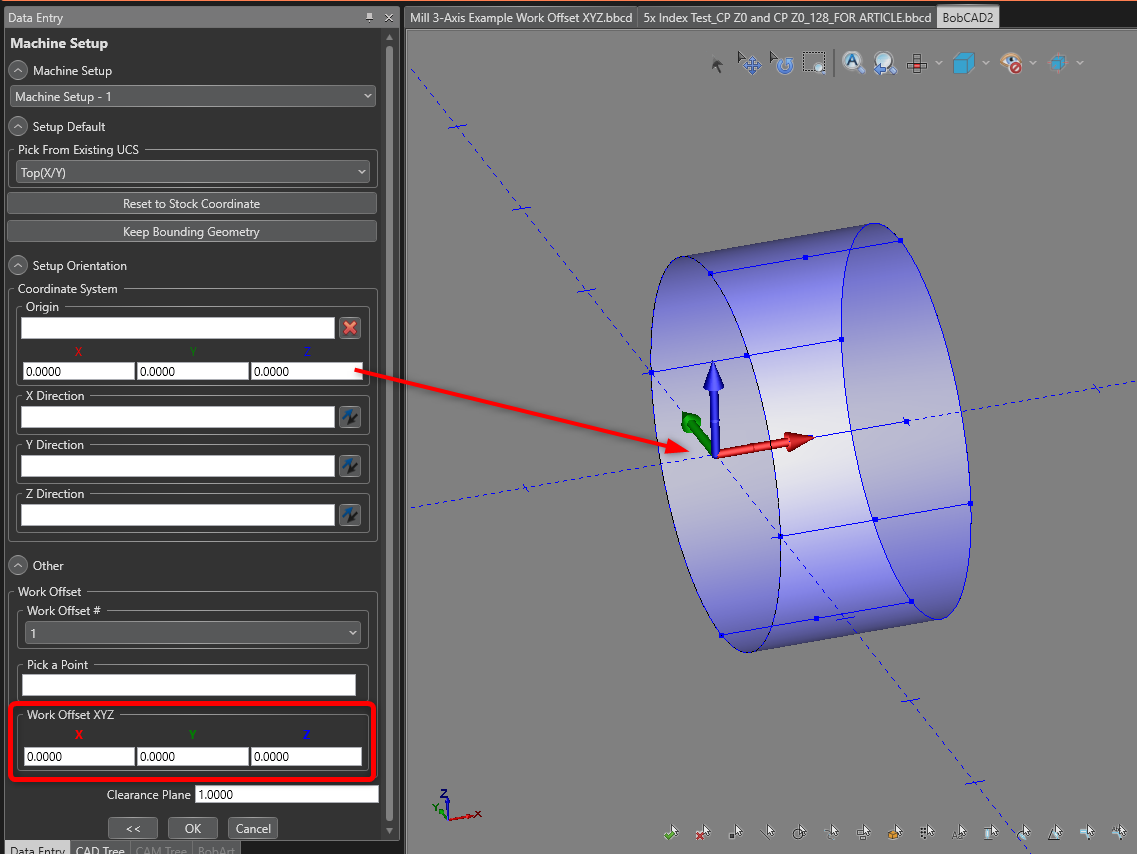

Pic 1 below shows where this Work Offset XYZ section is located on the Machine Setup page. This page shows up when initially going through the CAM Job Setup or if you right-click on “Machine Setup – 1” in the CAM Tree and click “Edit”.
Pic 1 – Machine Setup Page – Work Offset XYZ Section
The X, Y, and Z boxes are used to define the distance from what I will call in this article the “Virtual Machine Zero” (this is typically the top and center of the table, NOT the tool home) to the selected Work Coordinate System (WCS) setup on the Machine Setup page in the above “Coordinate System” section.
This Work Offset XYZ section is used to link the Virtual Machine Zero in the software to the Work Coordinate System (WCS) you set up on this page.
Note: This is Not the Machine Zero on your physical machine, but the Machine Zero of the virtual machine inside of BobCAD-CAM. This is an important distinction.

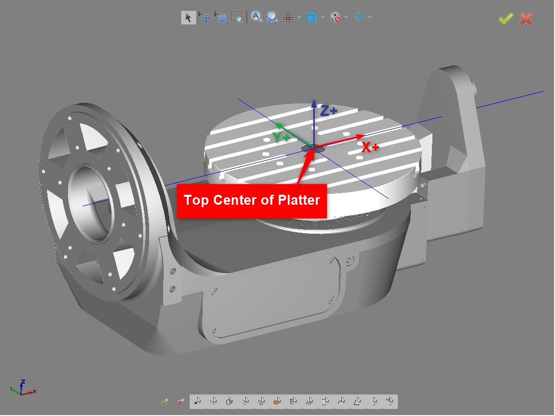

By default, typically, the Machine Zero location for the virtual machine in the software is defined at the Top Center of the table/platter. (See pic. 3 below)
Pic 3 – Top Center of Platter for BC_Table_Table Virtual Machine
It is important to understand where the Virtual Machine Zero in the software is located so that you can properly set up the Work Offset XYZ section on the Machine Setup page. You will see this being utilized in the coming sections of this article.

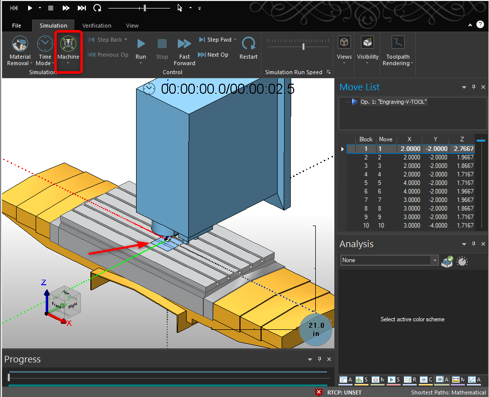

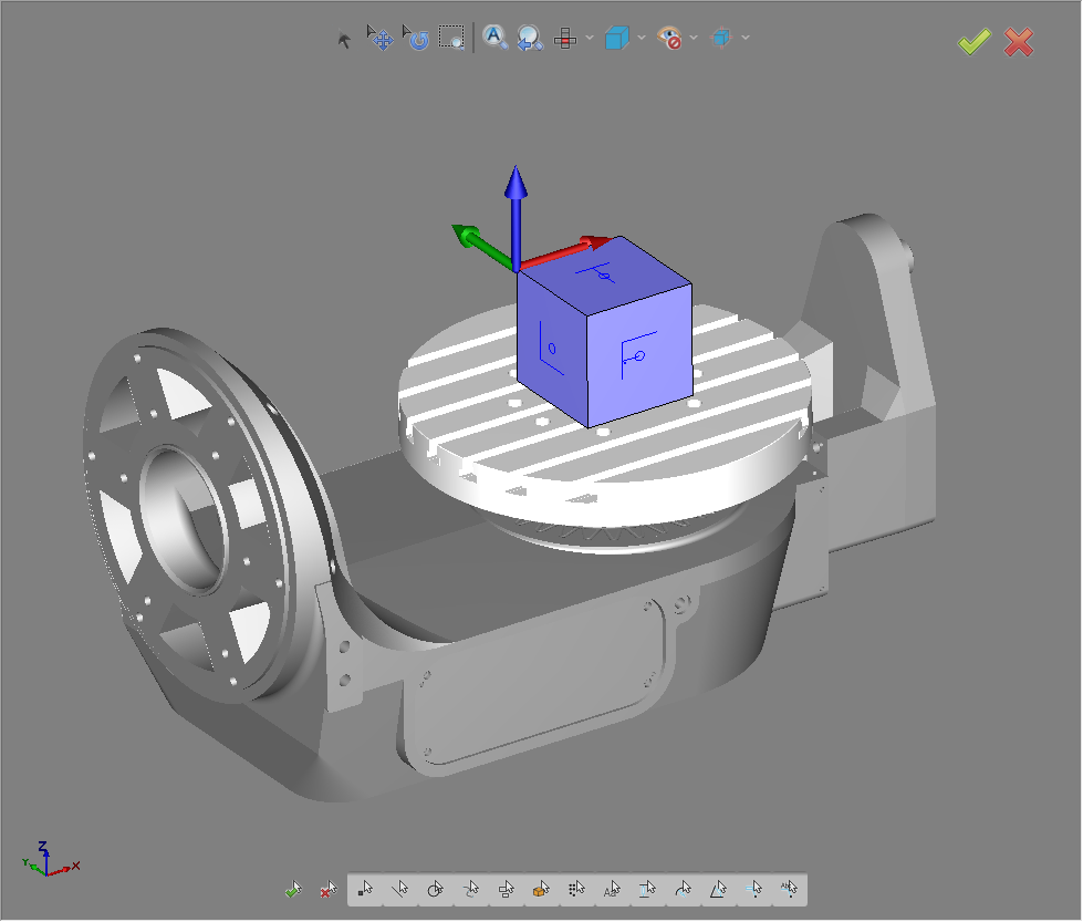

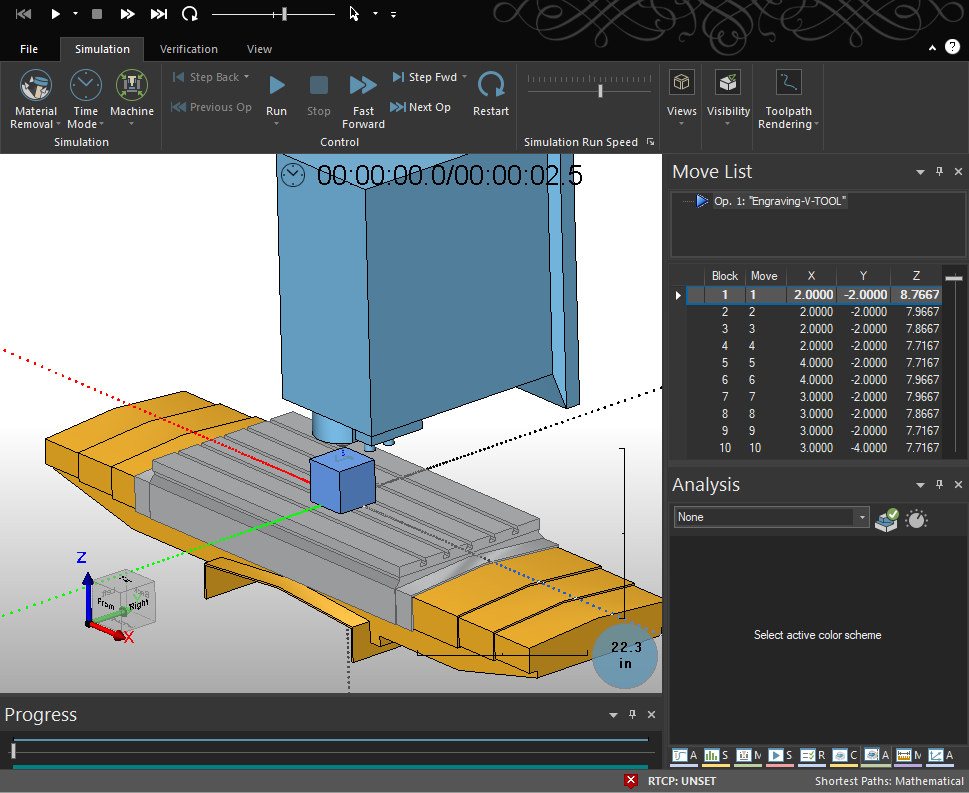

Let’s say we create an Engraving operation for the top letter “T” of the part and simulate the toolpath. If you have the Machine Sim Pro module, you will be able to view the machine. (See Pic 5 below)
Pic 5 – Simulation for a 3-Axis job with WCS at Top of Part and no Work Offset XYZ set up
Notice in pic 5 how the stock is inside the table of the machine. And, when you hit “Run”, you will receive the following error:
Pic 6 – Simulation Collision between Table and Tool Error
This is happening because the default Virtual Machine Zero in the software is located at the Top of the Table.
So, this is happening for two reasons. 1. the WCS was set up at the top of the part, and 2. The Work Offset XYZ section on the Machine Setup page is set to zero.
Now, of course, you can choose to ignore this error and continue through the simulation. However, to remove the error, navigate back to the Machine Setup page in the job. You will want to adjust the Z value by AT LEAST the thickness of the stock (more if the part is set up in a fixture) to move the stock up out of the table.

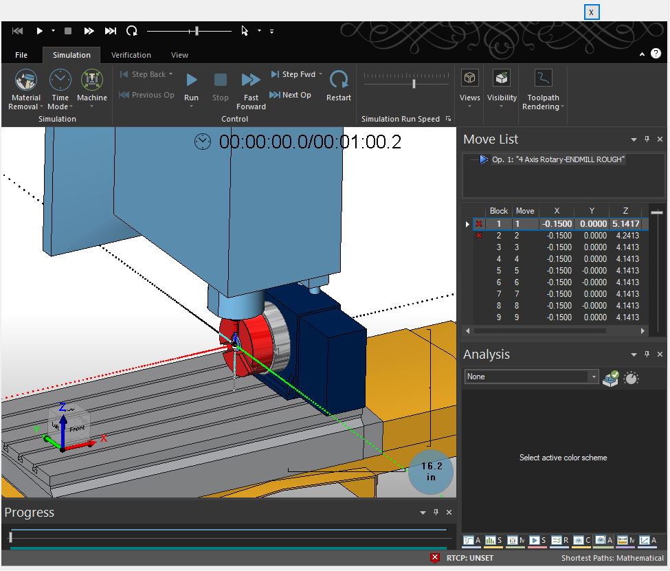

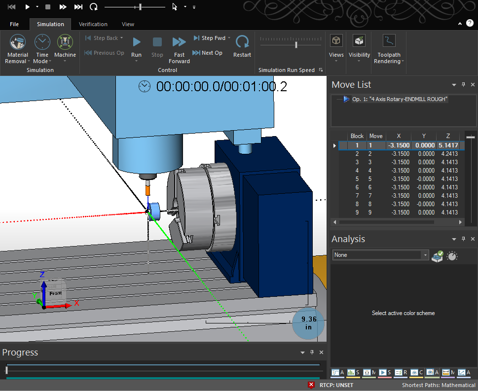

Let’s leave the Work Offset XYZ set to zero for now. If we apply a standard 4-Axis Rotary toolpath to the job and simulate the toolpath, we will see a similar problem as we did in the Mill 3-Axis example. (See Pic 10 below)
Pic 10 - Simulation for a 4-Axis job with WCS at Front Center of Part and no Work Offset XYZ set up
Similarly, if you try to “Run” a simulation, you will get a Collision between rotary_chuck and zaxis error as you see below:
Pic 11 – Simulation Collision Error

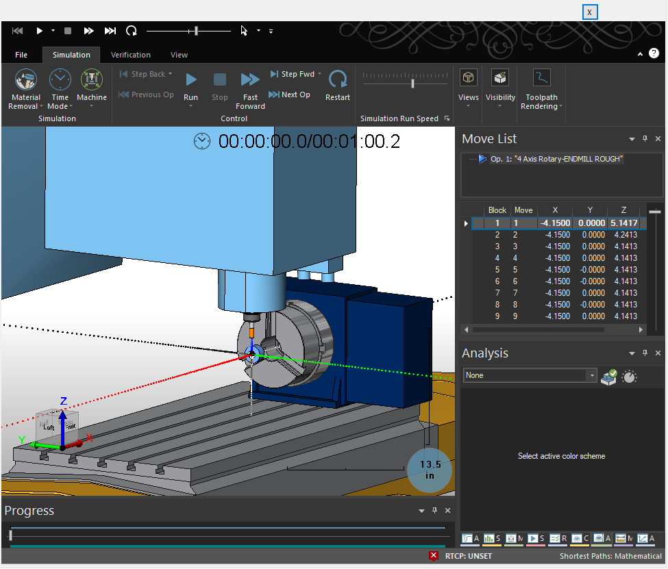

To remove this error, you simply need to adjust the Work Offset XYZ X value. Since the X-axis arrow for the WCS is pointing toward the chuck, we need to use a negative X value to move the stock out of the chuck.
In this example, the part is 1-inch long. I will set the X value to -4.000 to move it out of the chuck. The same rules apply as in the 3-Axis example. So, therefore I made the X move further away from the chuck. You can account for a fixture or jaws to get a more realistic view of where the part is actually located and view it in the simulation.
Pic 12 – X-4 Work Offset XYZ section of Machine Setup page
Pic 12 – 4-Axis Rotary simulation with proper Work Offset XYZ X value
This works similarly to 3-Axis in that all we are doing is moving the part out of the machine for simulation purposes to get a better and more accurate view of the part in our simulation.

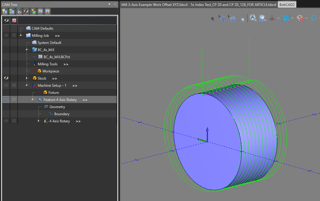

Pic 13 – WCS at the Front Top of the Stock No Work Offset Z value set
If you do not adjust the Work Offset there can be a couple different issues that arise. Firstly, you will notice that the toolpath looks strange and the tool orientation is not correct when backplotting (Right-click on the Operation in the CAM Tree and select “Backplot”) or simulating the toolpath. (See pic 14 below)
Pic 14 – WCS set to top of stock with no Work Offset Z value set and no shift in the feature.

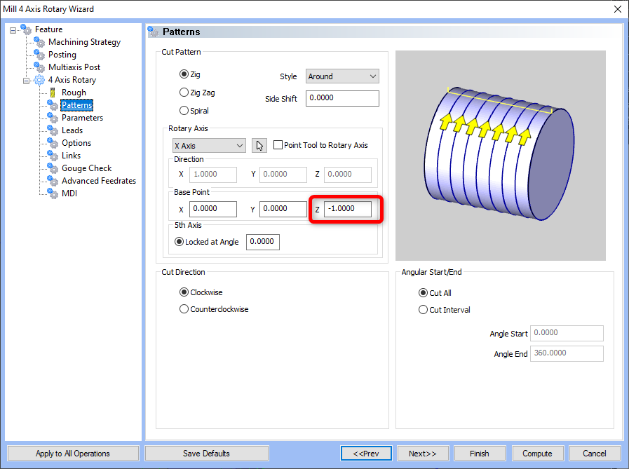

To fix this issue, you simply need to adjust the Base Point inside the Feature 4 Axis Rotary wizard. Go to the “Patterns” page and adjust the Z value. (See pic 15 below)
Pic 15 – Base Point Z set to Z-1
In our case, the stock has a 1-inch Radius. Since the WCS is set to the top of the stock, move in a negative direction back down to the center of rotation. This would be Z-1.0000.

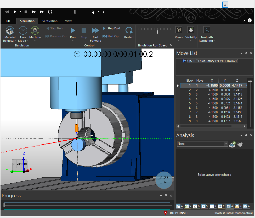

This will resolve the issue visually in the toolpath. However, when you load a simulation, notice where the part is in reference to the center of rotation. (See pic 16 below)
Pic 16 – Simulation with WCS at top of Stock, no Z value in Work Offset XYZ and Base Point moved in the feature
As you can see in the image above, this is not what we were after. The part is off-center of the chuck now. When you post out the g-code, you will notice that this is not correct either. It will post the g-code exactly as you see in the simulation. We want the center of rotation to match the center of the stock.

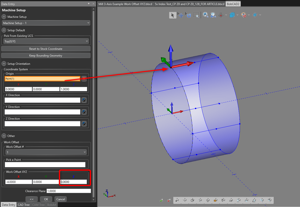

The solution is to adjust the Work Offset XYZ Z value to move our center of rotation back down to the actual center of the chuck.
Since we set the WCS to the top of the stock, we should move the Z value to a positive 1. As shown below:
Pic 17 – X-4 Z+1 Work Offset XYZ in the machine setup page
You may ask why this is positive and not negative like in the feature.
Important Note: The best way to describe the sign of the values in the Work Offset XYZ is to start from where ever the Center of Rotation is located to move incrementally from there.
So, in our case, if we start from the Center of the stock, since this is where we want the center to be located, we will move up a positive Z1.0000 to move the WCS back to the top of the stock.
Once we have adjusted the Work Offset Z value to Z1.0000 and keep the Base Point in the Feature set to Z-1.0000, we can now properly simulate and post out the g-code for the job.
Pic 18 – WCS Front Top of Stock, Work Offset XYZ with Z+1, Base Point in Feature with Z-1

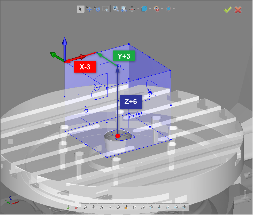

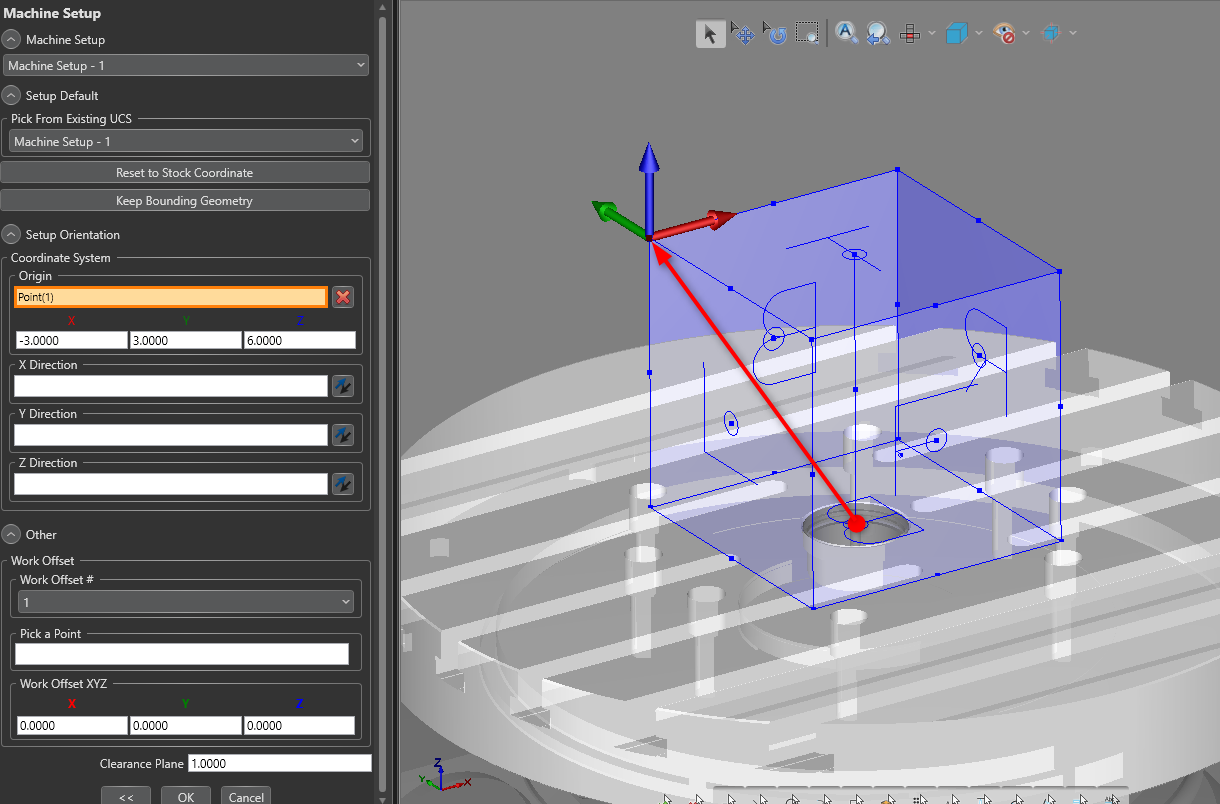

If we move the WCS to the Top, Back, Left of the stock, this means we are moving in all 3 linear axes X, Y and Z in relation to our virtual machine zero (Top Center of platter). This means we need to apply a shift in all three axes. (See pic 21 below)
Pic 21 – Move WCS to Top, Back, Left of Stock
From here, we need to adjust the Work Offset XYZ values to ensure proper g-code output and simulation. Adjusting the Work Offset XYZ will allow us to properly account for the shift off of the Virtual Machine Zero and thus get proper g-code output when it comes to toolpath that involves rotating the Rotation axes.
To do this, start from the Top Center of the platter and incrementally move up to the WCS you set up in the job for each axis.
Pic 22 – Work Offset XYZ values in the Machine Setup Page
To get the Top, Back, and Left corners of the stock, if we start from the Top Center of the platter, we will move Z +6, Y +3, and X -3.
Solution 1: These would be the values you would place in the Work Offset XYZ section.
Pic 23 – X-3 Y+3 Z+6 Work Offset XYZ section
