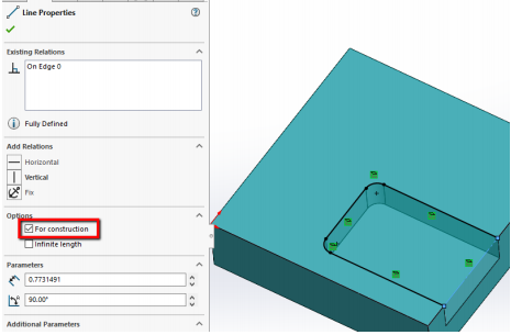

*Creating a Construction line in SolidWorks:
1.  Edit the sketch with the pocket geometry
2.  Click on all of the lines or arcs that identify the open edge
3.  Check the box ‘For Construction
4.  Click the green check mark
Chart Description automatically generated
