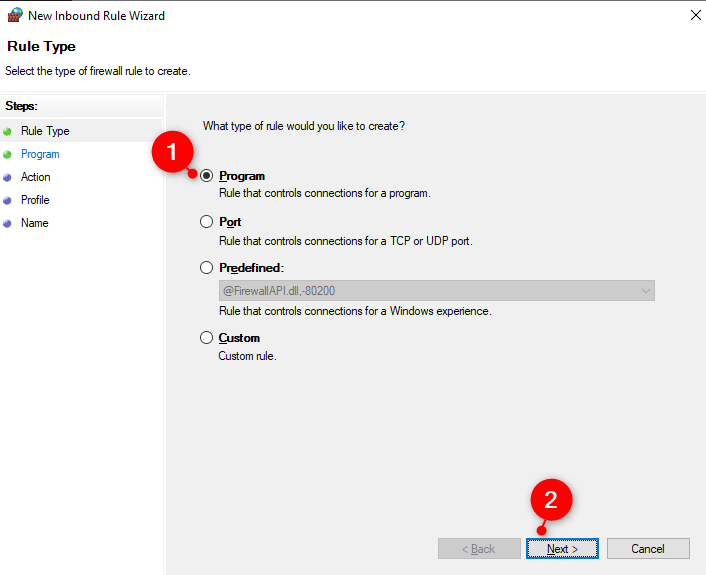

3. Select Program and then click Next.

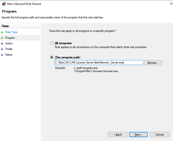

4. Select This program path and then browse to the location of the RLM server: C:\BobCAD-CAM License Server\BobNetwork_Server.exe Or, whatever location you moved the server to in the installation.

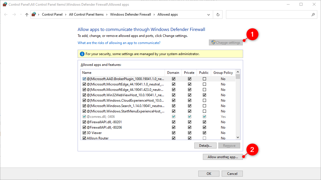

1. From the Windows Start menu, search and open “Windows Security”.
2. Click on Firewall & network protection
3. Select Allow an app through the firewall
4. Click on the Change Settings > Allow another app… link on the bottom.
A screenshot of a computer Description automatically generated

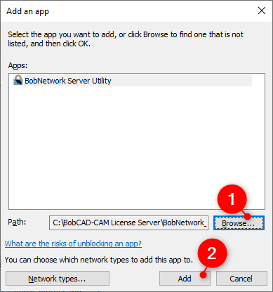

5. Browse to the location of the BobCAD server and open it: C:\BobCAD-CAM License Server\BobNetwork_Server.exe Or, whatever location you moved the server to in the installation.
6. Click “Add”.
7. Select all the checkboxes that apply to the rule. Domain, Private, and Public in the example below.
8. Click OK

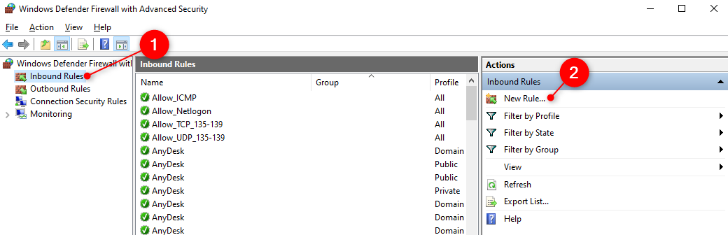

1. From the Windows Start menu, search and open ”Windows Defender Firewall”
2. Select Inbound Rules in the left-hand panel and click New Rule

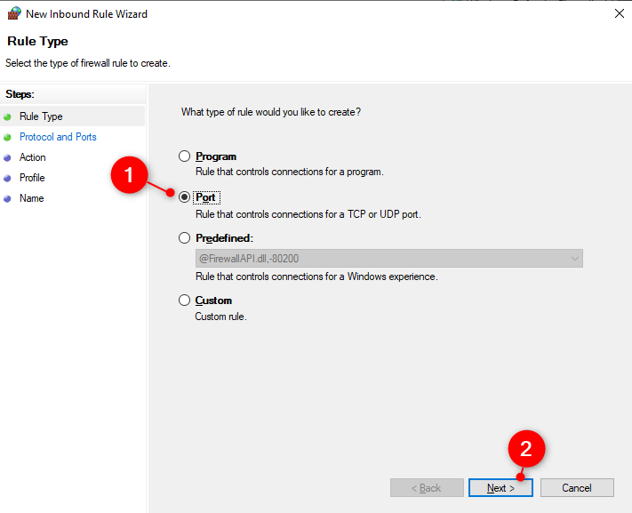

3. Select the Port radio button and then click Next.

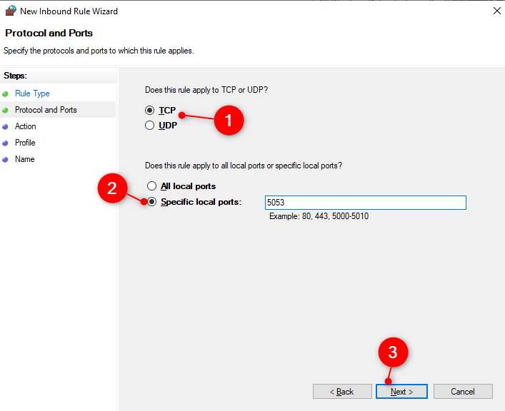

4. Select TCP and Specific local ports, enter the port number that you used to install the license server in the field provided (e.g. 5053 is the default port number) and click Next

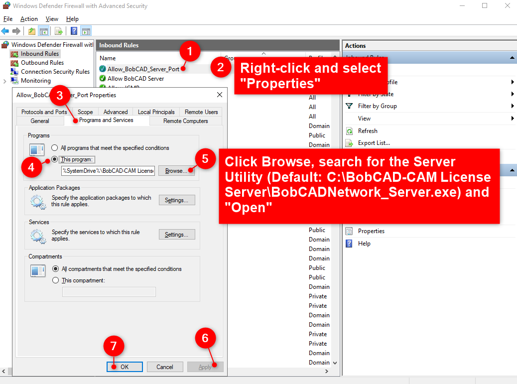

8. Select the new rule from the Inbound Rules list and click Properties
9. Click the Programs and Services tab, select This program, and browse to "C:\BobCAD-CAM License Server\BobNetwork_Server.exe" and click Open to the Properties dialog.
10. Click Apply, and OK the dialog.

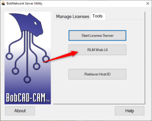

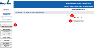

Restart the BobCAD-CAM Network License Server
Once you have added all the neccasary exceptions above, make sure to Reread/Restart the Servers.

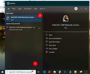

1. From the Windows Start menu, search and open, "BobCAD-CAM Network License"
2. Go to the Tools tab and select RLM Web UI
3. Click, "Reread/Restart Server", select ALL or bobcad for the ISV and click the REREAD/RESTART button
