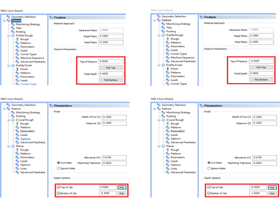

Splitting the Depths that each Operation will Perform
For especially large parts where even one operation has too many lines of code for a CNC to be able to read, the amount of z axis cutting that an operation will perform can easily be split up into multiple operations.
1.  While in the CAM Tree, right click on the feature with too much toolpath and hit Edit
2.  For any 2 axis milling operation, the depth that the operation will be cutting in can be found in the features page of the CAM Wizard, the top of feature is how high in the z axis that the toolpath will be created to and the depth of cut is how much deeper toolpath will be created based on the initial top of feature. This can be useful by reducing the depth of cut by half the desired amount and then copying this feature and using the final depth of cut as the new top of feature and the remnant depth of cut so that each operation is only a fraction of the original code.

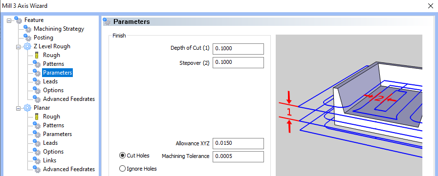

3.  For all 3 or more axis milling operations, the depth can be split up in the parameters page into several operations by changing the top and bottom of the job. A picture to illustrate these processes can be seen in the page below.
