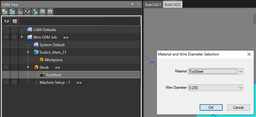

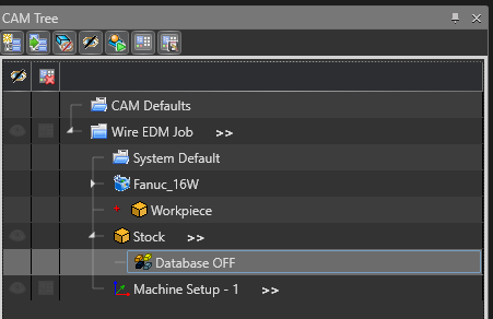

To check if your machine has a Cutting Conditions Database, start by making a Wire EDM CAM Job. After you setup the job, you can see the Cutting Conditions Database by expanding the “Stock” in the CAM Tree (See pic. 1). If there is a Material showing up, this comes from the Cutting Conditions Database. You can change this material by right-clicking on the Material and selecting “Edit”.
Wire EDM Cutting Conditions Database in the CAM Tree
Pic 1 – Wire EDM Cutting Conditions Database in the CAM Tree
If your machine does not have a Database, you will see under “Stock” that it says, “Database OFF” (See Pic 2)
No Wire EDM Cutting Conditions Database, Database OFF
Pic 2 – No Wire EDM Cutting Conditions Database, Database OFF

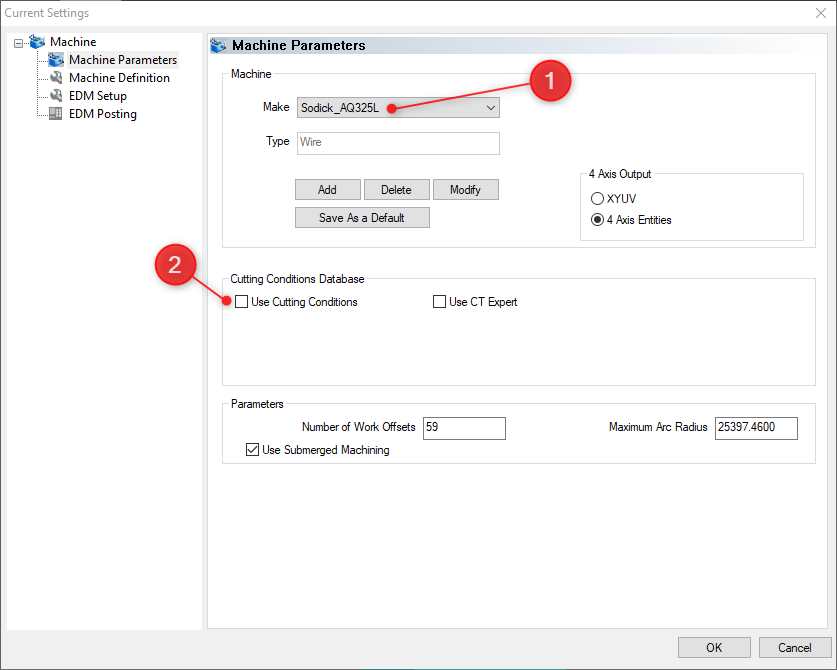

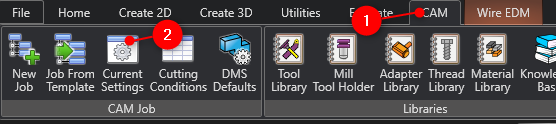

If for whatever reason you do see a database for your machine in the Technology folder (C:\BobCAD-CAM Data\BobCAD-CAM V(Version #)\Technology), but the “Stock” still says, “Database OFF”, this means that the Database is currently disabled. Follow steps below to enable the Database:
1. Go to the “CAM” tab at the top ribbon of the software and click “Current Settings”
Graphical user interface Description automatically generated with low confidence
2. Select your Machine from the “Make” drop-down box and enable “Use Cutting Conditions”

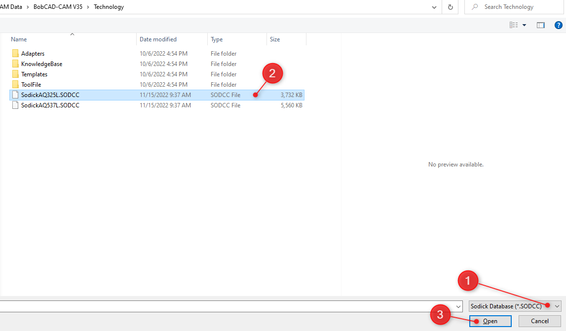

3. If the Database does not already show up, click “Select”, adjust the file extension at the bottom right, select your database and click “Open”

5. To Refresh the Machine in the Current Job, right-click on your machine in the Cam Tree and click “Edit”. Then, click “OK” to refresh the machine.
6. To refresh the Database, right-click on “Database OFF” and select “Edit”. Select your Material and Wire Diameter and press “OK”.

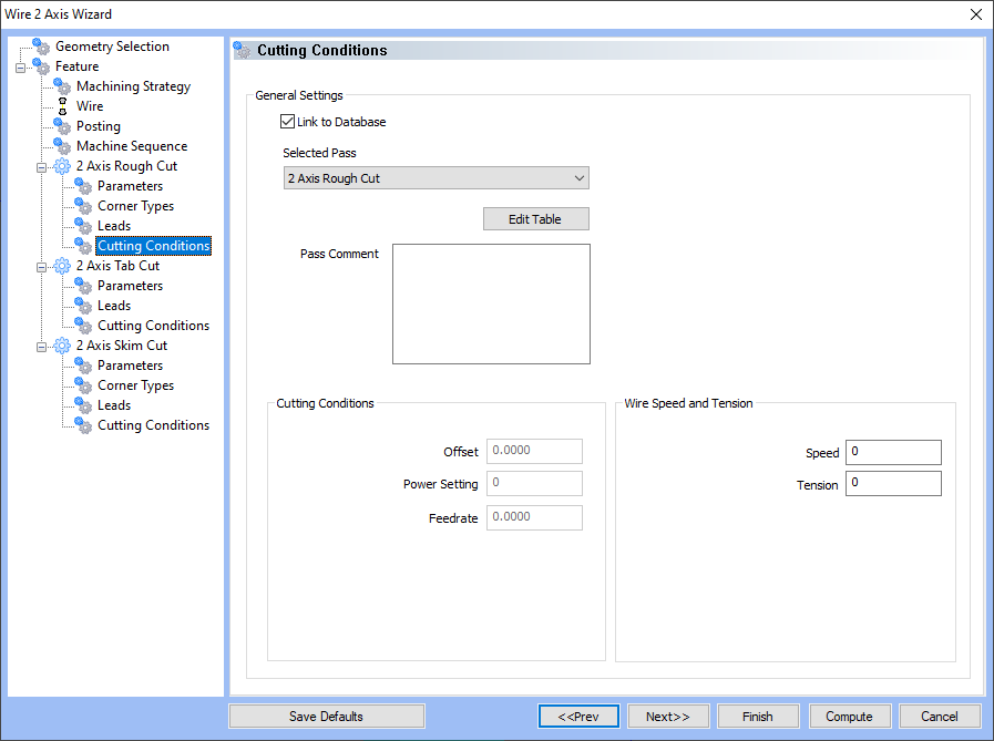

The information and steps below will help you utilize the Wire EDM Databases that are built into the software. So, when you get to the “Cutting Conditions” tab inside a Feature Wizard, you will see that the “Link to Database” option is checked off.

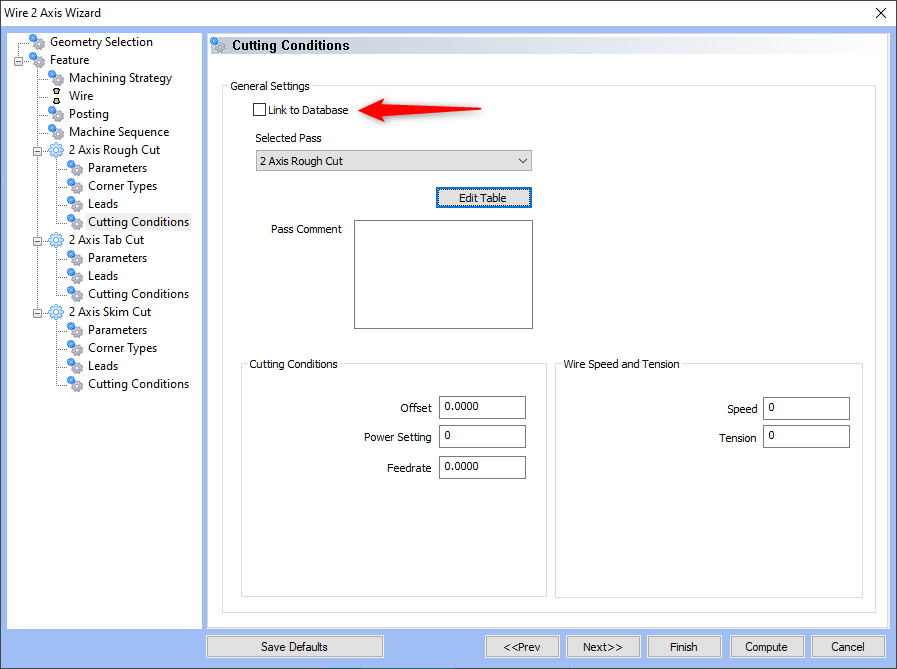

Option 2: Setup Cutting Conditions Directly in the CAM Feature
So, what if your machine does not have a Cutting Conditions Database or the Databases are not giving you the Conditions needed for your job? See is where you can utilize the “Cutting Conditions” page directly inside the Feature Wizard.
Whenever you make a new Feature for your Wire EDM job, each operation will have a “Cutting Conditions” tab so that you can set up these values. If you do not have a database, the “Link to Database” button should already be disabled on this page. (See pic 3)
Cutting Conditions Page in the Feature Wizard
Pic 3 – Cutting Conditions Page in the Feature Wizard

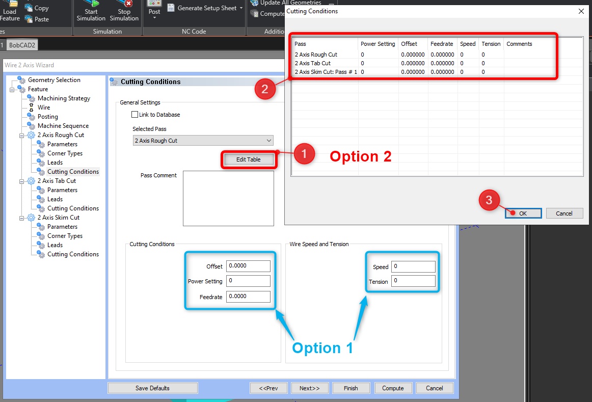

You can either enter the Cutting Condition Values inside the “Cutting Conditions” and “Wire Speed and tension” boxes, OR, you can click “Edit Table” and adjust all cutting conditions for the feature at once. (See Pic 4)
Adjust Cutting Conditions Values for Feature
Pic 4 – Adjust Cutting Conditions Values for Feature
These are the two different ways that you can set up Wire EDM Cutting Conditions inside of BobCAD-CAM.
