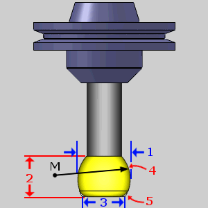

Barrel Standard
Machining Data
Tool Number - opens the Assigned Tools dialog box for you to change the tool numbering.
Override Offsets
Clear the Override Offsets check box to use the tool number to set the
Offset Register value.
Select the Override Offsets check box to allow for manual editing of the
- Height Offset - sets
the Height Offset to be used in the posted program.
- Diameter Offset - sets the Diameter Offset to used in the posted program.
Spindle Direction
CW - sets the spindle direction to clockwise. -
CCW - sets the spindle direction to counterclockwise
- Coolant - sets the coolant on code(s) which will be output for the operation. (See the note at the top of the topic for more information on the coolant options)
Use Custom Tool Shape for Toolpath - When a tool is assigned which has had custom geometry assigned by the user, this option will appear. This will allow you to either use the tool parameters specified in the Tool Data group, or the custom geometry.
- The tool will be defined using the parameters in Tool Data group of the tool page.
- The custom tool shape assigned by the user will be used to calculate the toolpath.
Feeds and Speeds
- Use System Feeds and Speeds
Select this check
box to automatically calculate the feeds and speeds.
Clear this check
box to type feeds and speeds values in the dialog box.
- SFM/SMM - is the surface feet/meters per minute feedrate.
- Feed per Tooth - is the feedrate for feed moves in units per tooth.
- Plunge Feed per Tooth - is the feedrate for plunge moves in units per tooth.
- Spindle RPM - is the revolutions per minute of the spindle.
- Cutting Feedrate - is the feedrate for feed moves.
- Plunge Feedrate - is the feedrate for plunge moves.
- Arc Slowdown % - is the amount of the feedrate to use when in arc moves. 100% is equal to the Cutting Feedrate.
Note: While editing the feeds and speeds, changing one value automatically calculates any other associated values. For example, if you modify the SFM value, the Spindle RPM, Cutting Feedrate, and Plunge Feedrate are automatically calculated.
Barrel Advanced
Machining Data
Override Offsets
Spindle Direction
Feeds and Speeds
Select this check
Clear this check
Barrel Tangent
Machining Data
Override Offsets
Spindle Direction

Barrel Taper
Machining Data
Override Offsets
Spindle Direction
Feeds and Speeds
Select this check
Clear this check
