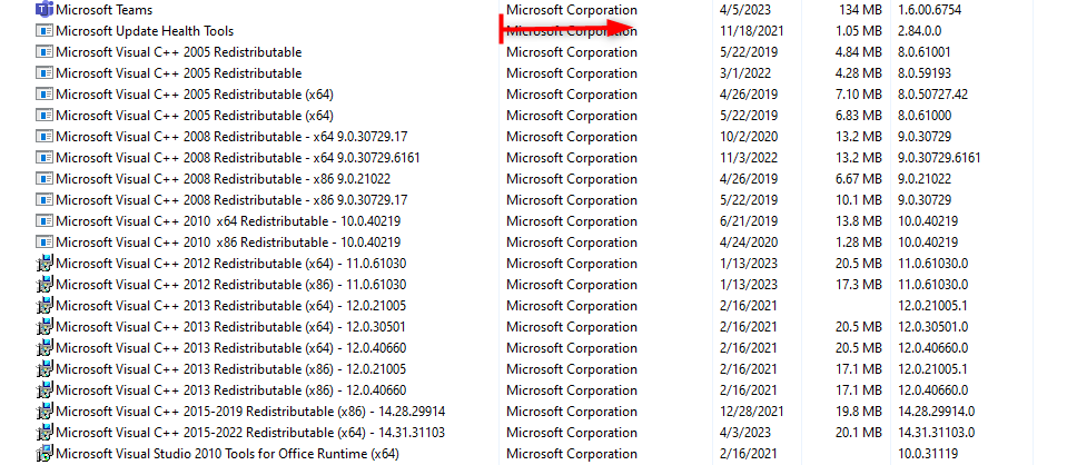

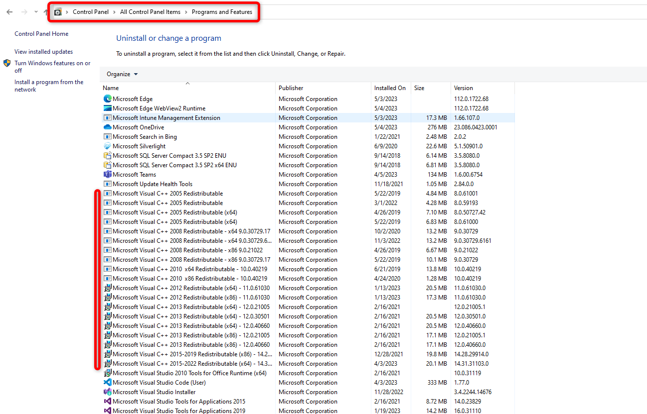

1. Go to Control Panel > Programs and Features and scroll down to the "Microsoft Visual C++ ..." section
2. Expand the "Name” section so you can see the whole build number
3. Navigate to the Installer Dependencies document and start installing these exact dependencies one at a time until the issue is fixed.
Note: Start with 2015-2022 x64 C++ Redistributable as this is typically the one that is missing or not up to date.
Note: You may need to Restart the computer after each install and test BobCAD upon restart.

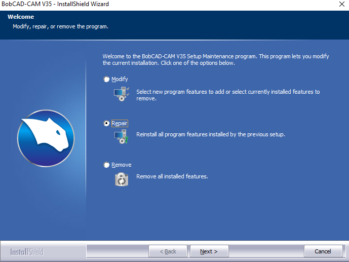

2. Once downloaded, navigate to your Downloads folder, right-click on the .exe file, and select “Run as administrator”.
3. Choose the “Repair” option if prompted in the Installation wizard and complete the installation
If you have enough permissions with the current user and there is no anti-virus blocking the software from installing, this should install all the proper files needed and the software should now open. If not, please proceed to the next section.

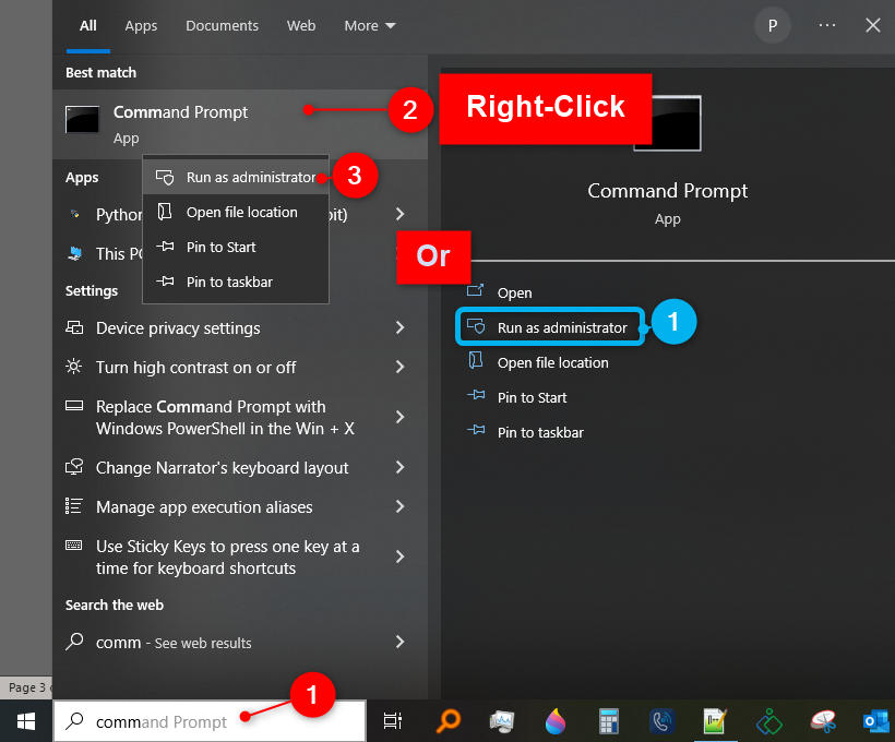

2. In the bottom Search Bar, type in Command Prompt, right-click on “Command Prompt: App” and select “Run as administrator”
3. Type in the following below and hit Enter (It should say, “The command completer successfully”)
net user administrator /active:yes

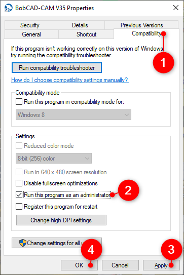

Note: If it does not open, try right-clicking on the BobCAD icon on the Desktop and select “Run as administrator”. If this opens the software, right-click on the BobCAD icon again, and go to “Properties”. Go to the “Compatibility” tab > enable “Run this program as an administrator” > Click “Apply” > and “OK”
