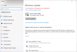

1. Check Windows Updates
Search "Check for Updates" on your computer. This will take you to the Windows Update page. Click the "Check for updates" button and let it run through all updates.  Once finished, restart your computer. Then, go back and double check to make sure that Windows is completely up-to-date because it may update in separate chunks.
Update Windows

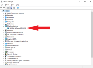

Open "Device Manager" on your computer and show your "Display Adapters". You should see an AMD or NVIDIA graphics card. If you just see Intel, you either do not have a dedicated graphics or the dedicated card was not properly installed on your computer. This will lead to your performance instability while using the software.
  Find Graphics Card Driver in Device Manager

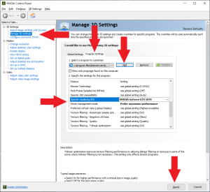

To link the Graphics Card: Right-click on your desktop and select your control panel for your graphics card. For newer versions of Windows, you may need to search it in the Search bar instead.
For NVIDIA, go to "Manage 3D settings" --> "Program Settings". click the "add" button and select BobCAD. Then, click apply at the bottom right of your screen. (Note: you can also set "OpenGL rendering GPU" to your Graphics Card and set "Power management mode" to "Prefer maximum performance") Restart you computer when finished.
BobCAD Crashing. Link BobCAD to NVIDIA graphics card

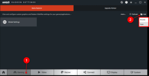

For AMD, there is a tab called "Gaming". Click on that and click the "Add" button. find BobCAD and add it. Restart your computer after it is linked.
BobCAD Crashing. Link BobCAD to AMD graphics card

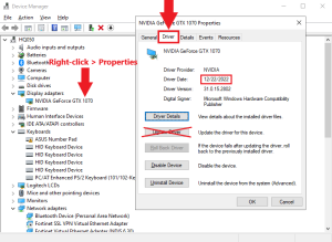

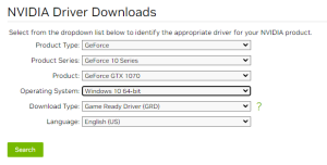

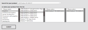

3. Check Graphics Card Updates
Go back to the "Display Adapters" in your Device Manager for your graphics card. Right-click on it and select "Properties". Click on the "Drivers" tab. You can update it from here, but it usually does not always find the most up-to-date driver. We suggest going to the company's website to find the most up-to-date drivers and download and install it from there. Restart computer when finished.
Check Driver Date of graphics card in Device Manager.
Current Website to find Graphics Card Updates:
NOTE: These links below are subject to change by the providers. ALWAYS make sure you are on the official provider's website before downloading anything.
NVIDIA: https://www.nvidia.com/download/index.aspx
AMD: https://www.amd.com/en/support
NVIDIA Driver Downloads AMD Driver Downloads

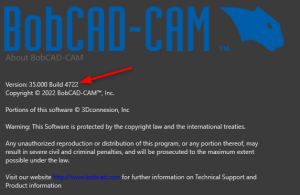

4. Check BobCAD Updates
You can find out which build number you are currently on by going to File --> Help (in the right corner)
(SolidWorks: Question Mark > BobCAM Help > About BobCAM... Rhino: BobCAM > About BobCAM...)
Then, navigate to the software updates page to check for updates: HERE
Example:
Check BobCAD build number for updates latest updates for V35 BobCAD
