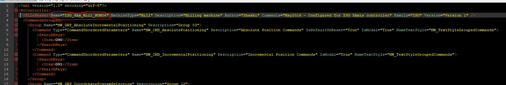

2. Go to the very top of the controller file and where it says “Name” in the file header (see pic. Below), change it to a different name. This is the name that will show up in the NC Editor simulation when selecting your controller.
3. Click “Save As” and save out the .ccxml file as a different name. (IMPORTANT NOTE: Make sure you change this line first and save the file before changing anything else.)

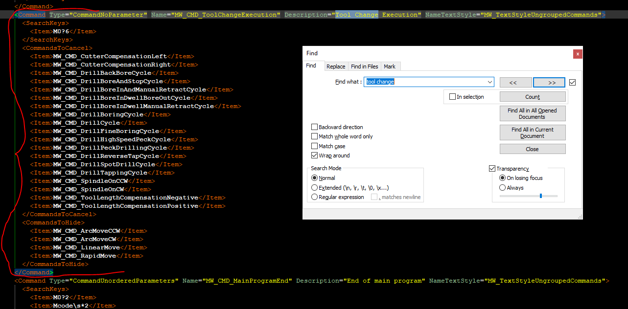

4. Press CTRL + F to pull up the search window. Type in “Tool Change” and hit the next arrow to get here (see pic below):
5. Delete the whole command block for the tool change execution (highlighted in the picture above)

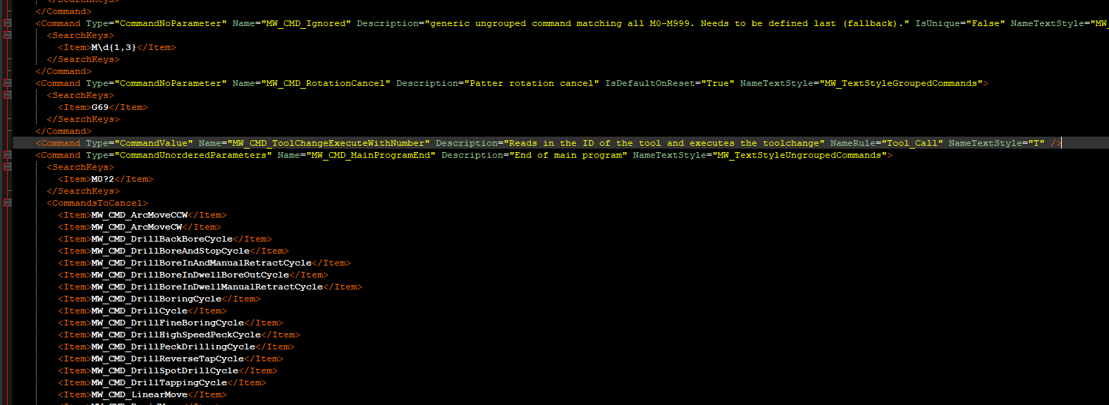

6. Insert the code below in place of the existing tool execution:
<Command Type="CommandValue" Name="MW_CMD_ToolChangeExecuteWithNumber" Description="Reads in the ID of the tool and executes the toolchange" NameRule="Tool_Call" NameTextStyle="T" />

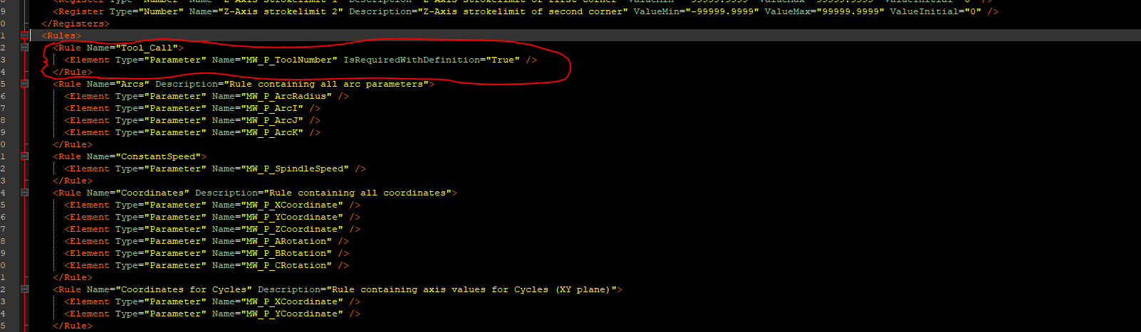

7. Next, go to the “Rules” section (Press CTRL+F and search “Rules”) and insert the following rule code below:
<Rule Name="Tool_Call">
<Element Type="Parameter" Name="MW_P_ToolNumber" IsRequiredWithDefinition="True" />
</Rule>

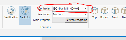

9. You should now be able to see the controller that you have created in the drop-down box under the “Simulation” tab. Select it.
10. Test it out. If it works, in NC Editor, go to File/Options/Controller and select your new controller that you have made and press “OK’. This will make the new controller your default controller inside of NC Editor.
