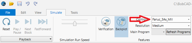

3.Β  In notepad open up one of the CCXML files in the folder: C:\Program Files\NCEditor V1\Controllers
4.Β  Change the file header name at the top of the CCXML to the name of the machine as shown in the picture below.
5.Β  Press the control and β€œF” key at the same time to open up the find command prompt and search for the word β€œDNC”. The find prompt should bring you to the DNC setting line, which can be edited to change the default baud rate, parity, etc.
6.Β  When the DNC Settings have been fully edited in step 5, go to save as and change the save as type to β€œAll Files”. Next type the same file name that was used in step 3 for the file header name, but add on the extension ”.ccxml” so that the NC Editor will be able to read this file and hit save.
7.Β  Now go back into the NC Editor and in the simulate tab select the controller that you just made. The user should notice that now when going to the Tools tab and selecting the start DNC transfer module that the Port, Baud Rate, Parity, etc. Will now be filled in based on what the user type in on step 5.
