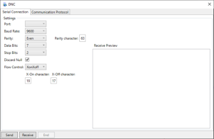

This step-by-step guide will show you how to set up default settings for the DNC / RS232 Communications inside of NC Editor. These settings include; Baud Rate, Data Bits, Delay Character, Delay Line, Discard Null, Flow Control, X on/off values, Parity, Parity Character, Port, Receive/Send Timeout, Remove Comments, Stop Bits among other settings.
These settings can be set up as a default in NC Editor so that you do not have to make changes every time you send or receive a new program to the machine.

Once NC Editor is opened, go to “Tools” tab > “Start DNC Transfer” to open the DNC Settings dialog (The above image shows the dialog that pops up). This is where you will edit the DNC settings and send or receive programs to your machine

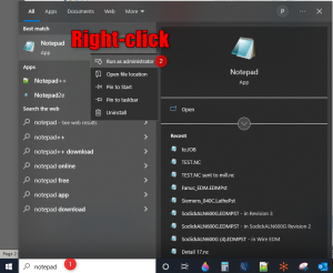

3. In the Search bar of your computer (Bottom Left), type in “Notepad”, then, Right-click on “Notepad” and select “Run as Administrator”.

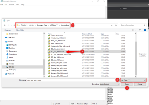

4. In Notepad, go to File > Open and navigate to the following folder: C:\Program Files\NCEditor V1\Controllers . Set the File type to “All Files (*.*)”. Then, select your controller and click “Open”.

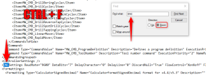

5. Once opened in Notepad, Hit CTRL + F to pull up the “Find” tool (If this does not work, go to “Edit” > “Find” at the top toolbar.) Type “DNC”, make sure the Direction is set to “Down” and hit “Find Next”. You will see a line called, “DNCSettings” in the file.
6. Make all necessary changes to the DNC settings on this line in this .ccxml file. You can change the values or if a setting is set to “True”, you can change it to “False” to disable that setting.
7. Once finished, Hit File > Save or CTRL + S to save the changes.
8. Now, reopen NC Editor and navigate back to the DNC Transfer dialog. You should now see the change in the DNC settings.
