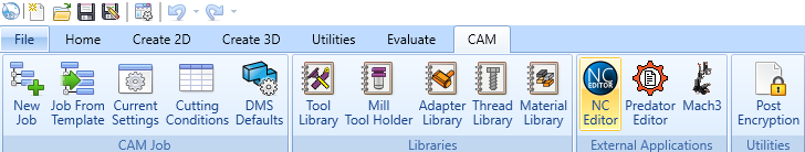

1.Β  In the CAM Tab left click on NC Editor.

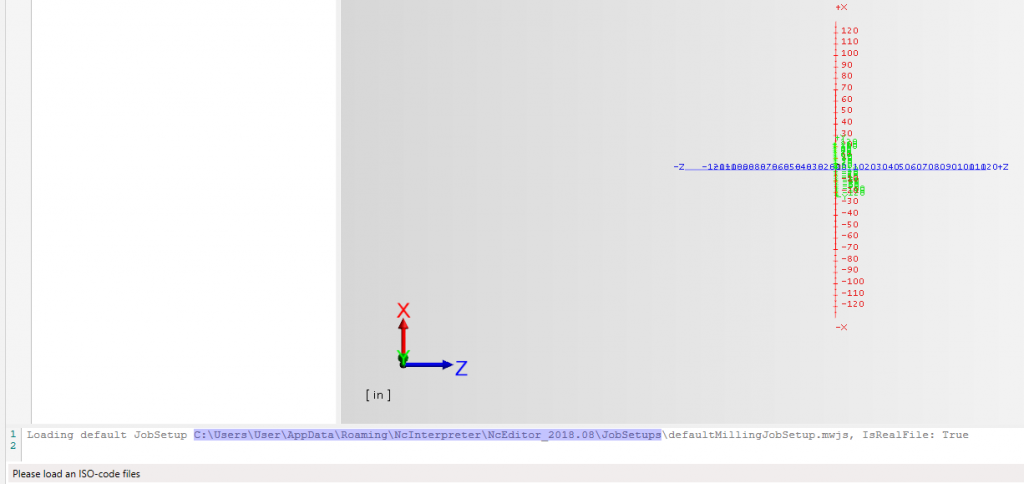

2.Β  At the bottom of NC Editor, copy the folder up to JobSetups as shown in the picture below.
3.Β  Paste the file location into a file explorer window
