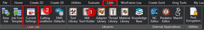

1. Go to the "CAM" tab in the top ribbon and select, "Current Settings"

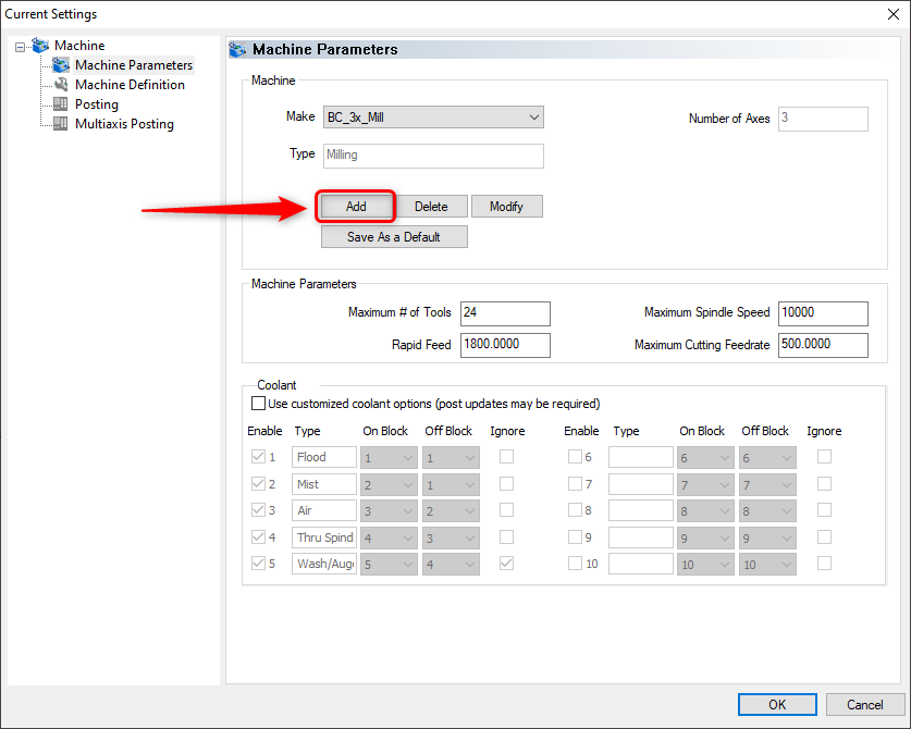

2. On the initial "Machine Parameters" page, click the "Add" button to add a new Machine.
3. Give it whatever name you would like and set up the Type and Axis fields. Click, "OK" when done
Note: Make sure your new Machine name is selected in the "Make" drop-down box before proceeding to the next step.

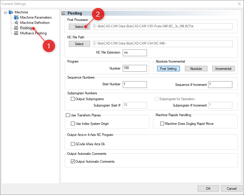

4. Navigate to the "Posting" tab in the left-hand column
5. Click, "Select" under "Post Processor" and select your new post processors from the following location: C:\BobCAD-CAM Data\BobCAD-CAM V(version #)\Posts\(Machine Type)
