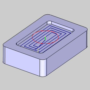

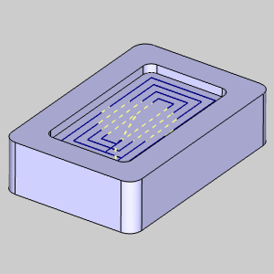

ToolpathEditor_PolygonPick.png Polygon Pick - This selection method will allow you to define an area of selection by using multiple single clicks to define a polygon. An example of this can be seen in the image below. Click here to see an example.
CheckBoxSelected.png Inside - Defines the area affected by the command. With this check box selected, the toolpath elements within the Trim Boundary will be trimmed and relinked.
CheckBoxCleared.png Inside - Defines the area affected by the command. With this check box cleared, the toolpath elements outside of the Trim Boundary will be trimmed and relinked.

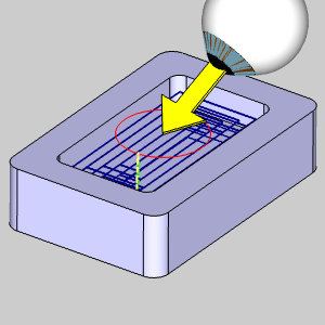

Usage - determines how the Trim Boundary is used. This gives you the ability to alter the direction the Trim Boundary is projected through the toolpath elements. The available list items are:

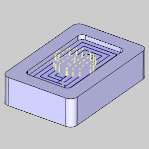

When Retract / Plunge is chosen as the Link option, this value allows you to set the Z plane height to be retracted to for the toolpath elements being adjusted.
