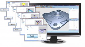

The next stage in the process of using CAD/CAM software involves the creation of Toolpath (cutter-path) which is the actual path that the cutting tool takes to machine the part. A CAM Tree-Job Manager will help you keep each machining operation organized and properly sequenced so that the g-code program produces the best possible cycle time for the job. 2, 3, 4 & 5 axis toolpaths are all developed to produce efficient roughing and finishing cycles. The Machine Setup should already be created in the Job Tree because you setup your stock. A Machining Wizard is a series of dialog boxes that step you through a process with a “Next” button until done where a “Finish” button would close the wizard and save everything you set for a toolpath machining strategy. When Wizards are used in the creation of toolpath two things happen.
New users create programs in a fraction of time over toolpath creation without using wizards and secondly, nothing is forgotten or left behind in making toolpath that is accurate and properly calculated based off of the tools you setup for the job. Toolpath Wizards start by allowing you to choose the areas of the part to apply a specified toolpath (planar, spiral, z-level etc) within a boundary or an entire part, set clearances and height of rapid moves for the tool.
Then you can choose the type of cutting pattern (zig-zag or single direction cutting), cutting direction (climb or conventional), roughing parameters, custom tolerance and cut-depth options, lead-in and out options, toolpath linking options (how you want to connect one path to another) and other custom machine options. When finished you will automatically generate the toolpath so you can visually inspect it. This takes place for each separate operation. If a change is needed you can simply go back into the operation and edit it. Then re-generate the toolpath. Once you have created toolpath for each operation you are ready to move into the next phase of the process.
