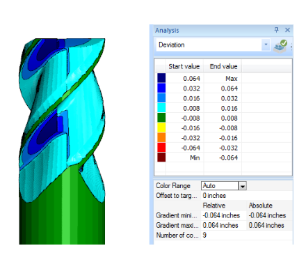

After we’ve run the first Advanced Rough toolpath, we’ll want to create another index to rotate the part 180 degrees and machine from the other side. Using these 2 index systems, the roughing toolpath will remove the bulk of the material, but, did we get it all? It’s not always easy to tell if we did get it all, which is why we ran a deviation report to find out if there is any leftover material or gouges.
deviation analysis in bobcad cnc software
The report shows color mapping of the range of material left. In this example, we can see some darker blue areas showing us we still need a little more roughing before we can move to the finishing toolpaths.
