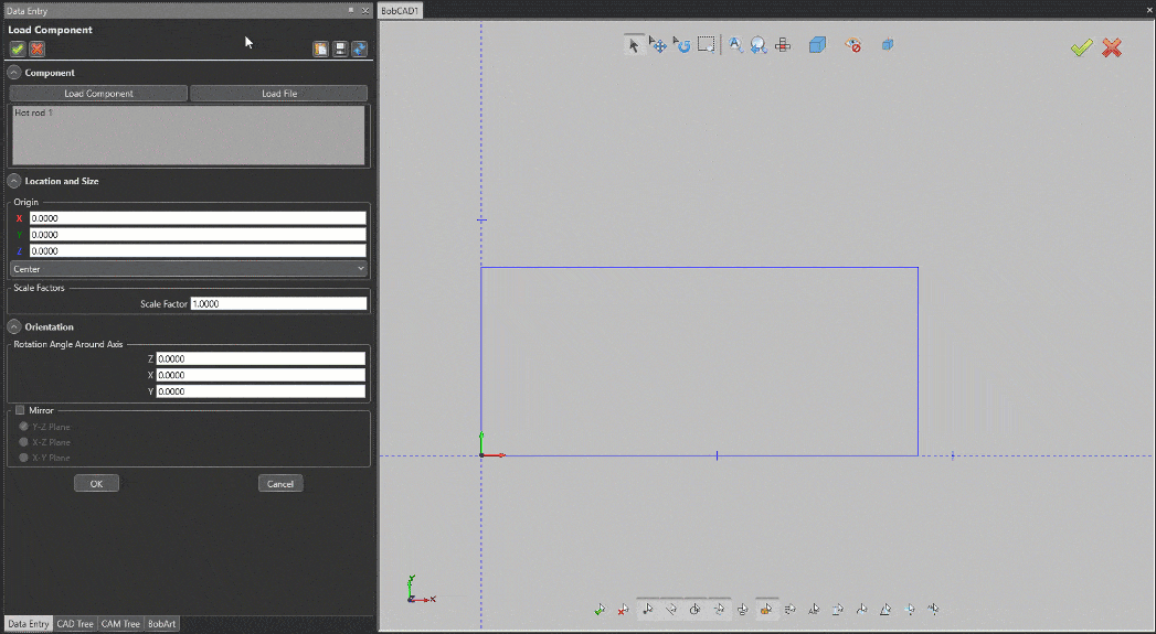

3. Component Library for Reusable Geometry
The new component library lets you store, preview, and insert commonly used 2D and 3D geometry. Standardizing features and assemblies save time and ensure accuracy, particularly valuable for high-volume or repeat jobs.

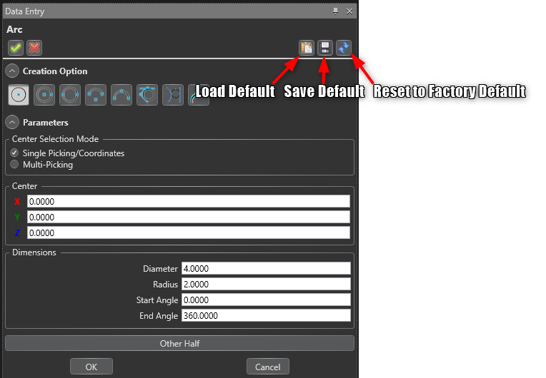

4. Custom CAD Default Parameters
BobCAD-CAM V38 allows you to define and save your own defaults for CAD operations, whether you’re working in inches or metric. This eliminates repetitive data entry and ensures that your preferred machining standards are always applied from the start.

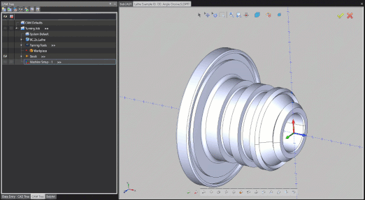

5. Smarter Lathe Picking from Solids and Surfaces
Instead of extracting wireframe profiles manually, you can now select solids or surfaces directly when programming lathe operations. This reduces setup steps and makes turning workflows more intuitive.

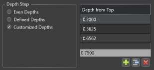

6. Customized Depths in 2-Axis Milling for More Control in CAD CAM Software
Not all cuts should be equal. With V38, machinists can now define variable depth cuts in 2-axis milling. This makes it possible to rough aggressively at the top and switch to lighter passes in critical finishing zones — improving efficiency without compromising part quality.

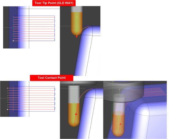

7. Improved Boundary Trimming Options
Toolpath control has been refined with options to trim based on the tool tip or contact point. This ensures precise machining near edges and minimizes the risk of gouging or leaving excess stock, especially during complex 3-axis finishing operations.

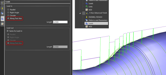

9. Rotary Machining Enhancements
Rotary and multi-axis machining get a significant boost with improved collision avoidance, expanded lead-in/lead-out strategies, and new trimming controls. These upgrades provide safer toolpaths, smoother transitions, and greater flexibility for complex parts.

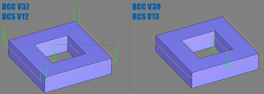

10. New “Fade” Lead Type & Enhanced 5-Axis Deburring
Surface finish is king, and these enhancements deliver. The new Fade lead type allows for a smoother ramp into and out of cuts, while 5-axis deburring now favors stable 3+2 motion, reducing abrupt repositioning and improving consistency across parts.
Image 9
More Rigid 5-Axis Toolpath Motion For Better Surface Finish
Toolpath Calculation improvement for 5-Axis Simultaneous motion. Ensures more 3+2 motion and minimal 5-aixs motion. No need to set any parameters in the CAM Wizard! The toolpath calculation will automatically handle this.
  • Consolidated 3+2 Behaviour
    • The common direction algorithm has been enhanced for deburring to ensure a 3+2 orientation with minimal 5-axis movements.
    • This minimizes undesired 5-axis motions, resulting in safer and more accurate machining.
