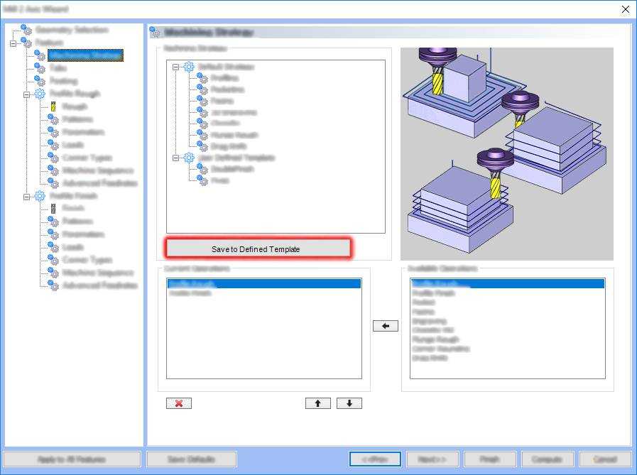

  2. Click Next>> twice to move to the Machining Strategy page.
    Notice the Save to Defined Template button at the bottom of the Machining Strategy group. This is the option we will use later, but for now, move through the wizard and alter the tools of the selected operations, and any of the values you would like to be set differently the next time this User Defined Template is used.

  1. Once all the tools and operation values have been updated in the wizard, move back to the Machining Strategy page.
  2. Click the Save to Defined Template button.
    The Save As dialog appears.
Important: The location of the saved template should not be altered by the user. Be sure to name the file appropriately, but the templates can only be read from a single location, and so, that location should not be changed.
  1. Give the template a name.
  2. Click Save.
    The Save As dialog disappears, and the template name appears in the User Defined Template section of the Machining Strategy list. This template will now be available for this feature type in the future.
