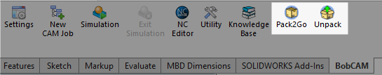

Easier Access to Pack2Go / UnPack
You can now Pack2Go or Unpack inside the CommandManager BobCAM tab to provide easier access to these functions.

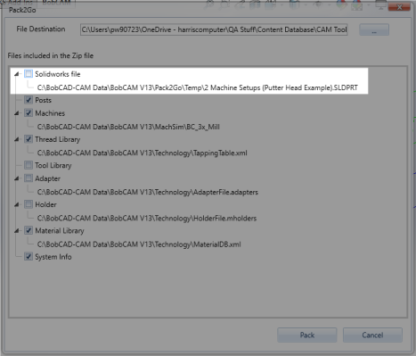

Pack2Go: Exclude The Main Part File From the Pack2Go Zipped Folder
Inside the Pack2Go dialog, it is now possible to uncheck the SolidWorks Part file and Pack the files without including the main file. This was primarily added to make it easier to transfer just Post Processors from computer to computer.
