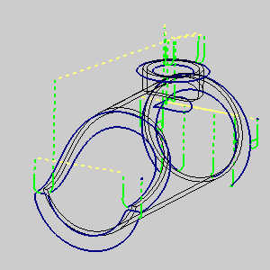

This tutorial explains how to create a Deburr operation and adjust that operation to output in 3 Axis.

    Notice the additional places toolpath has automatically been placed now that we are using a tool capable of undercuts.
Part 8) Simulation
    Notice the operation able to do undercuts.
    Notice the bottom edge on this side of the part is not finished in order to avoid a collision between the top extrusion and the tool arbor.
