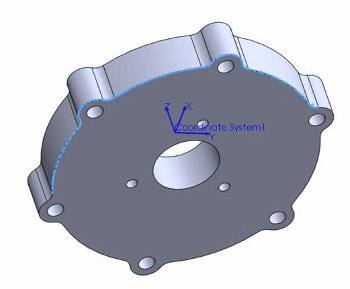

Geometry Selection Example
Loop Selection
The following example shows you how to use the SolidWorks loop selection options.

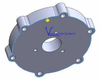

  1. In this example you want to profile the outside of this part. When selecting the geometry for the feature, point to the bottom edge of the part and right-click to display a shortcut menu.
  2. Click Select Loop to automatically select a loop connected to that edge. Notice that the vertical face was selected. To change the selection to the bottom loop, click the yellow arrow shown next.
  3. By clicking the selection arrow one time, the selection changes to the desired bottom loop. Now click in the Selection Manager and you are ready to edit the machining feature in the CAM tree.

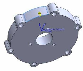

  4. Suppose that you do not want to select the entire profile, point to the edge, right-click and click Select Partial Loop. This allows you to manually click edges and list them in the Selection Manager. When finished, click OK.
    The next image shows the Profile feature used with partial loop selected.
If you need to clear the selections or delete an item, right-click an item in the Selected Items list and select the appropriate command. You can also click a selection in the graphics area to clear the selection.
