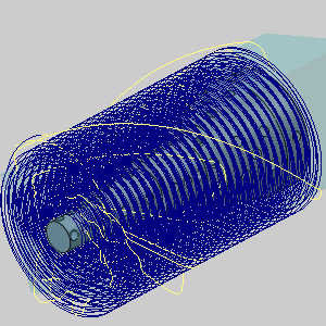

  10. Click Compute.

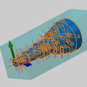

    Notice we are machining all the way to the back of the stock.
    We will update this in the next part.
Part 7) Edit the Machining area
  1. Right click the feature in the CAM Tree and select Edit.
  2. Click Parameters in the tree on the left of the wizard.
  3. Click the Part definition tab.
  4. In the Part definition group click the Machining area button.
    The Machining area dialog appears.
  5. In the User limits group select the check box for Axial.
  6. Set the End value to 6.750.
  7. Click OK.
    The dialog disappears.
  8. Click Compute.

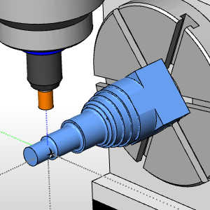

Part 8) Simulation
  3. Set the Stock to Transparent and the Workpiece to Show.
    Notice we are machining to the end of the part but do not collide with the chuck.
    This was adjusted by limiting our machining area.
  4. To close simulation, in the BobCAMmenu, click Exit Simulation.

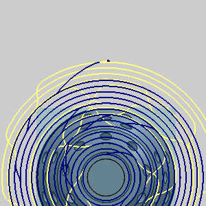

Part 9) Edit the feature

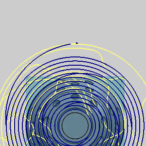

In this part of the example we will adjust the axis offset, and the link type to see how they affect the resulting toolpath.
  1. Right-click the feature and select Edit.
  2. Click Parameters.

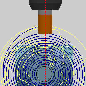

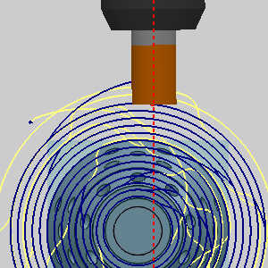

  3. In the Axis offset group, set the Tool diameter (%) to 10.
    This will move the tool closer inline with the axis of rotation.
Tool diameter (%) : 40 Tool diameter (%) : 10

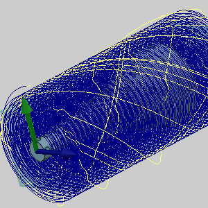

  1. In the Non-cutting moves group, update the Ramp angle to 20.
    This adjusts the angle of the entry move.
Ramp angle : 5 Ramp angle : 20
  1. Click Compute.
Cuts Along Curve
