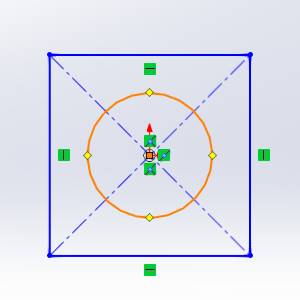

  4. Click Front Plane, and select Sketch.
    The Sketch ribbon becomes available.
  5. Select the Center Rectangle function.
    The function opens in the Property Manager
  6. Move your mouse to the origin.
  7. With the point visible, click the origin.
  8. Move your mouse up until a value of x = 4 , y = 4 is reached, and click again.

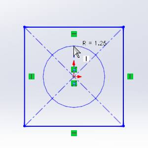

  9. Select the Circle function.
    The function opens in the Property Manager.
  10. Move your mouse to the origin.
  11. Click the origin.
  12. Move your mouse up until a value of 1.25 is reached, and click again.
  13. Click Exit Sketch.

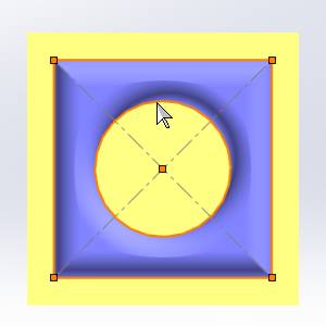

Part 5) Cross-Section
  1. By default the Cross-Section is set to Convex Arc.
    In the Radiusfield, type 0.500. Notice that the cross section preview is updated in the dialog.
    All of the other settings remain at the default values.
  2. Click OK.
    Notice that the feature geometry defines the boundary of the emboss, and the cross section defines the shape of the emboss vertically in Z. The Application Type, Add, means that the feature is added (or raised) in the positive Z-axis. The Z-height of the feature is 0.500 inches because of the 0.500 inches (Convex Arc) cross section used.

Part 7) Select Multiple Chains for a Single Feature
The following section shows how the Emboss Regular feature handles more than one geometry selection.
Tip: In the BobART tree, click My Regular Emboss 1 - Subtract. Notice that the feature geometry is highlighted in the graphics area. You can use this preview to locate each feature when the BobART tree contains multiple features.
  1. In the BobARTtab, right-click Geometry, and click Re/Select.
    Notice that the previous feature geometry is still highlighted. This shows that it is still selected.
  2. Select the rectangle.
  3. Set the Application Type to Add.
  4. Set the Cross Section to Convex Arc.
  5. To update the model, Click OK.
    Notice that the common areas of the two loops are not included in the emboss.
