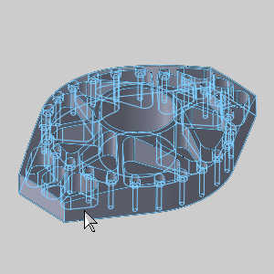

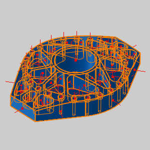

Part 5) Surface paths
  3. Select the model.

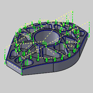

  2. In the Tilting group, set the Machining type to 3 axis.
  3. Click Compute.

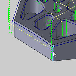

Part 7) Simulation

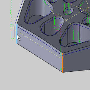

    Notice the operation is also trying to do the four vertical edges as well.

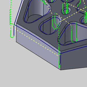

Part 10) Edit the feature
  1. Notice the toolpath on the corners of the part.
  2. Right-click the feature and select Edit.
  3. Click Parameters.

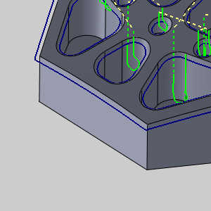

  4. In the Geometry input group of the Surface paths tab, click the ellipses button next to Exclude edges.
  5. Select the corner edges.
    Repeat this on the other side of the part.
  6. Click Compute.
