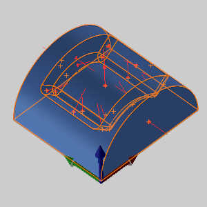

  5. Click the ellipses button next to Floor surfaces.
    The Re/Select Geometry dialog appears.
  6. Select the bottom of the part as seen in the image below.
  7. Click OK.
  8. Click the ellipses button next to Wall surfaces.
  9. Select the walls of the part as seen in the image below.
  10. Click OK.

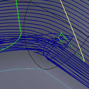

    Zoom into the corner and notice the toolpath.
Part 3) Simulation
  2. Click Play to view the Roughing operation in simulation.
    In this case we can see the wall is finished nicely without gouges.
    But we can see wild swings in the corners while machining the fillet:
