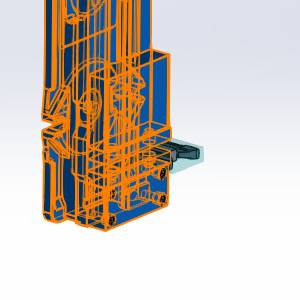

With everything in the job completed already, we could simply simulate, and post out the code.However, in order to see the fixture in the simulation, and check it for collisions, we will need to assign geometry as our fixture.With the Setup1 configuration active, we can simply assign the components in their current orientation as the fixture.
  1. Click on the CAM Tree - Manager tab.
  2. Click the icon next to Machine Setup - 1 in order to expand it.

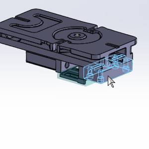

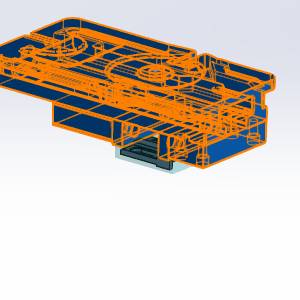

  3. Right-click Fixture, and select Re/Select.
    The Fixture dialog appears with focus on the Solid Body list.

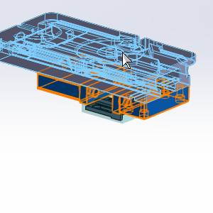

  4. Select each component of the vise.
Note: In the images above the bolts on top of the fixed jaw, and the vise handle mount are not selected.Since the fixture selection is used to check for collisions in the simulation, you may choose to leave particular aspects of the vise assembly unselected.
  1. Click (OK).
    The Fixture dialog closes, and the icon is no longer seen in front of the Fixture item in the CAM Tree.This shows that geometry is currently assigned.

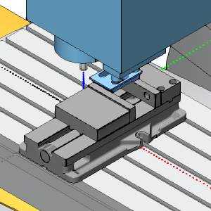

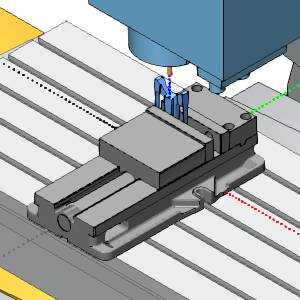

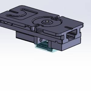

    As the simulation runs, notice the changes in the orientation of our vise.These are the various configurations we have assigned as our fixtures.
Machine Setup - 1 Machine Setup - 2 Machine Setup - 3
