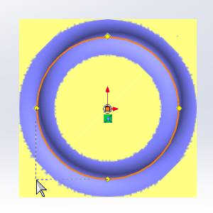

  1. By default the Selected Geometry list has focus, so In the graphics area, select the arc we created earlier.
Part 5) Setting the Cross-Section

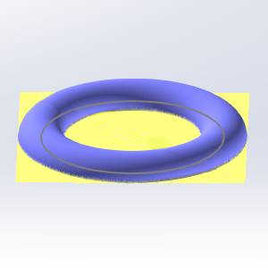

  1. In the Cross-Section section, confirm that Convex Arcis selected.
  2. In the Radiusfield, type . Notice that the cross section preview is updated in the dialog box.
    All of the other settings remain at the default values.
  3. To update the canvas, click Apply.
Note: Notice that the cross section, defined in the Emboss dialog, is swept along the entire length of the feature geometry. The cross section defines the shape of the emboss vertically in Z. The Application Type, Add, means that the feature is added (or raised) in the positive Z-axis. The Z-height of the feature is because of the radius (Convex Arc) cross section used.

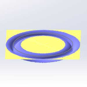

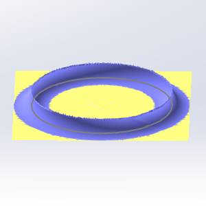

  1. In the Cross-Section section of the Embossdialog, click the drop down currently showing the Convex Arc option and select Concave Arc instead.
  2. To update the model and show the result of the new setting, click Apply.

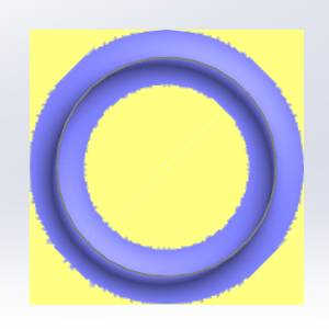

    Again, the defined cross section is swept along both sides of the selected feature geometry.
  3. In the Attributesection of the Emboss dialog, update the Application Type to Subtract.
    This means that the feature is lowered in the negative Z-axis direction.
  4. Click OK to regenerate the model and exit the dialog.

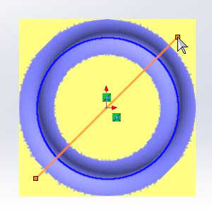

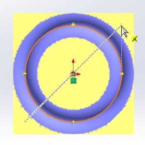

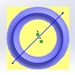

Part 7) Create a Line
  1. Right-click the sketch in the Feature Manager Design Tree, and select Edit Sketch.
  2. Select the Line function.
  3. Hover over the bottom corner of the circle.
    With the construction lines are visible, click your mouse and move to the top right of the circle.
  4. With the construction line visible, as seen in the above image, click again to create the line.

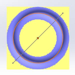

  5. Move your mouse and double-click to end the line function.
  6. Click Exit Sketch.

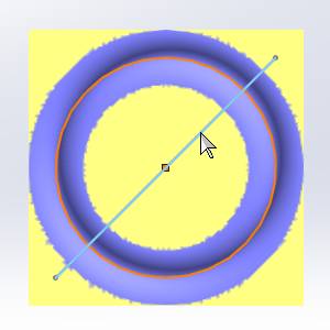

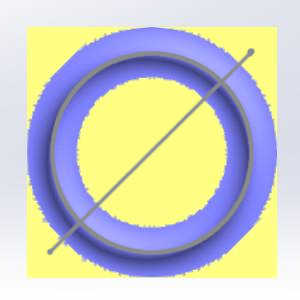

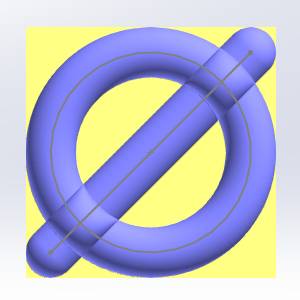

Part 8) Select Multiple Chains for a Single Feature

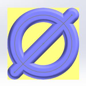

You can select multiple chains for a single Emboss Swept feature. The process of sweeping the cross section along the chain to create the emboss is applied to each chain regardless of how many chains are selected.
Tip: In the BobART tree, click My Emboss Swept 1 - Subtract. Notice that the feature geometry is highlighted in the graphics area. You can use this preview to locate each feature when the BobART tree contains multiple features.
  1. In the BobART Manager, right-click Geometry, and click Re/Select.
    The Emboss dialog opens again and the previous feature geometry is still highlighted. This shows that it is still selected.
  2. In the graphics area, click the line to select it.
  3. Set the Application Typeback to Add.
  4. Set the Cross Section back to Convex Arc.
  5. Click Apply.

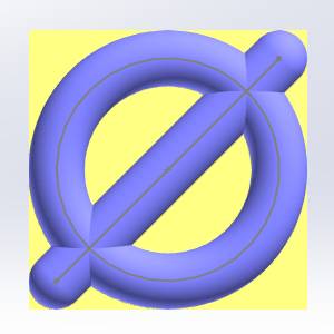

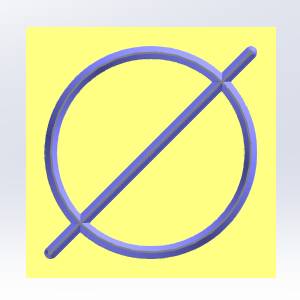

Note: When combining multiple emboss features, the Add application type adds the results of each feature together. In the previous images, because the two separate chains were selected for a single Emboss Swept feature, they are created at the same height (). The following images show the result of creating two Emboss Swept features and assigning the arc to one feature and assigning the line to the other feature.
The result is that the intersecting areas of the two features are added together. The arc used for each feature results in the total Z-height of the model of .00.

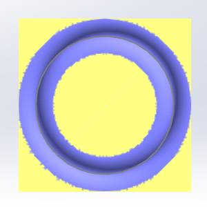

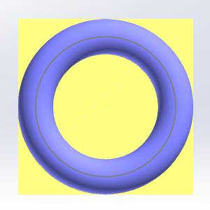

Part 9) Modifying the Cross Section
When using the cross-section types, Convex Arc or Concave Arc, you can modify the cross section using the Start Angle and End Angle parameters.
  1. In the Cross Section section, set the Start Angleto 45.00.
    This causes the cross section to start at the midpoint of the arc (45 is half of 90). The range of possible values for the Start Angle and End Angle are from 0.00 to 90.00 degrees.
  2. Click Apply.
Note: The Z-height of the model is now much lower than the previous result.
