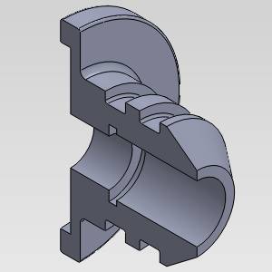

This tutorial is designed to highlight some of the key areas of the lathe module. In this example, we will be working on both the OD, and the ID.Operations will include Turning, Grooving, and Threading.

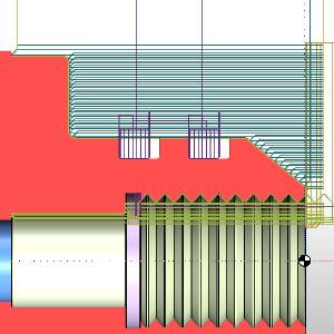

Blank Toolpath

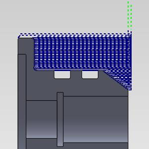

Part 4) Turning the Part
In this step we create a Lathe Turning feature, assign Rough and BasicFinish operations, and define the parameters of those operations.
  1. In the CAM Tree, right-click Machine Setup - 1 and selectLathe Turning.
  2. Click SelectGeometry.
    The Lathe Wizard hides and the Selection Manager opens to allow geometry selection.
  3. area To select the entire model as our geometry:
    1. Click OK to confirm the geometry selection and return to the Lathe Wizard.
  1. In the Lathe Wizard, click Next>>to continue to the Feature page.
Adjust Feature Settings
  1. In order to avoid cutting the grooves with these operations, select the Remove Primary Undercut check box in the Undercutgroup.
  2. To continue beyond the selected geometry, select the check box for Extensionand enter a value of 0.2500into the End Distance box.
  3. Click Next>>to continue to the Machining Strategypage.
Set the Machining Strategy
  1. Select Rough / Finish in the Machining Strategy section of the Machining Strategy page to assign a Rough and BasicFinish operation to the feature.
  2. Select Parameters.
Adjust Parameters
  1. Adjust the Zvalue of the Finish Allowanceto 0.0010.
  4. Select Finish.
Tip: In this case, our stock has already been faced off.In order to avoid unnecessary feed movement, we use the Trim to Stock option to set trim the toolpath to the Operation Stock.
Select a ToolandCompute
  1. Click Tool Crib.
    The Tool Crib launches.
    The Tool Library launches.
  3. Select tool number 277to highlight the VNMG - 1/32RAD - FINISH TURNINGtool.
  4. Click OKto return to the Tool Crib.
  5. Click OKto return to the Lathe Wizard.
  6. Click Compute.
Blank Toolpath

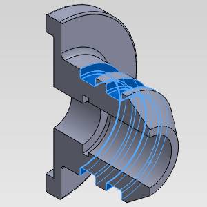

Part 5) Grooving the OD
In this case, we have two grooves that need to be completed on the OD of the part and one groove on the ID.Right now we will focus on the two OD grooves.
  1. Right-click Machine Setup - 1 in the CAM Tree and selectLathe Groove.
    The Lathe Wizard launches.
  2. Click Select Geometry.
  3. In the graphics area:
    1. Click OK.
  1. Click Next>>to continue to the Feature page.
  1. In the Feature page, under the Constraintssection, select From Geometry.
  2. Select Groove.
  3. Click Tool Crib.
    The Tool Library Launches.
  5. Select tool number 281to highlight the 1/8 WIDE - 1/64RAD - OD GROOVE tool.
  6. Click OK.
  8. Select Patterns.
  2. Select the check box for Rough Allowance and adjust the Xvalue to 0.0050.
  3. Under Semifinish Pattern, set the Overlapvalue to 0.0050 to ensure that each of the downward semifinish cuts will go slightly beyond center.
  5. Click Compute.

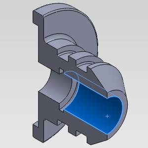

Part 6) Boring the ID
Now that we have completed the outer diameter of the part, we need to begin working on the inner diameter.The first thing we will work on is a basic Rough and Finish.
    1. Press confirm the geometry selection.
Set Feature Settings
  1. In the Feature page under Material Approach, set the Rapid Planeto 0.0500.

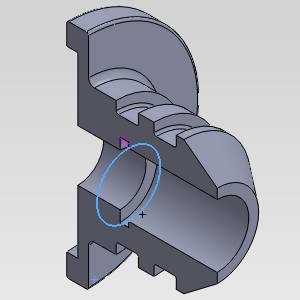

  2. Under Feature Parameters, select IDfrom the Feature Type list to set the orientation of the feature.
  3. Under Undercut,select the Remove Primary Undercutcheck box so that our rough does not try to complete the ID groove feature.
  4. Select the check box for Extensionand enter a value of 0.4500into the End Distance box.
  5. Select Rough.

  2. Click Compute.
Blank the Toolpath

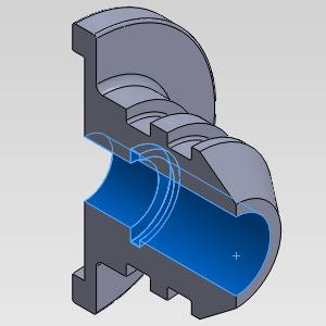

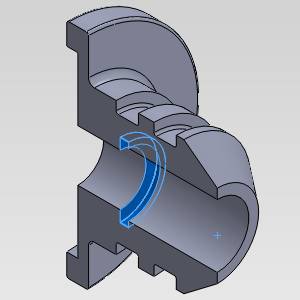

Part 7) Grooving the ID
  1. In the Feature page, under Material Approach, set the Rapid Planeto 0.0500.
  3. Under Constraints,select Custom and then clickPick since the material has already been removed for a portion of this geometry, we can change where the toolpath begins.
  4. Highlight the
  5. top edge of the smaller wall of the groove, connecting entity to the right of the groove, and left-click.
  6. Confirm the geometry selection.
    The Lathe Wizard returns.
  7. Select Groove.
Select a Tool
  1. Click Tool Crib.
  2. Click GROOVE and then click AddFrom Tool Library.
  3. Select tool number 280to highlight the 1/8 WIDE - 1/64RAD - ID GROOVE tool.
    In the Tool Crib:
    2. Click OK.
  5. Select Parameters.
Set Parameters and Compute
  1. Select the check box for Rough Allowance and adjust the Xvalue to 0.0500.
  3. Click Compute.
Blank Toolpath

  1. In the Feature page, under Feature Parameters select IDfrom the Feature Type list.
    1. In the Start Distance box enter a value of 0.3750.
    2. In the End Distance box enter a value of 0.0300.

  1. Click Compute.
Blank Toolpath
Part 9) Simulation
Open and Close Simulation
  1. In the Modulesmenu, click Simulation.
For help with simulation, view GettingStarted with Simulation.
Tip: The Simulation contains a CutSim tab.Clicking on the Advanced Properties button will launch the Parameters dialog allowing you to select the Enable check box in the Section plane group. This will put the stock in the section plane view seen in the image above.Leave the values as they are and click OK.
