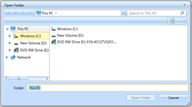

Bcc.FolderOpenDialogBox
Bcc.FolderOpenDialogBox({InitialDirectory})
Description
Displays a folder chooser dialog box
The primary input of this function is a Table which can include the following keys:
  • InitialDirectory – The directory displayed within the folder chooser dialog when initialized
Return
Returns the selected folder file path when OK button is selected.
Returns nil if Cancel button is selected.
Examples
foldername = Bcc.FolderOpenDialogBox({ InitialDirectory="C:/BobCAD-CAM Data/BobCAD-CAM V32/LuaPlugins/My Plugin"})
