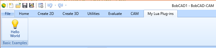

Step 2 - Add the button to the ribbon
With the Bcc.AddCommand function, we will create a ribbon tab, add a group to the tab, and add our button to fire our script.  All of this will be done inside the ConnectToBCC()function.
function ConnectToBCC()
       -- Add a button the ribbon to fire the Hello World function when pressed
       Bcc.AddCommand({ TabName="My Lua Plug-ins", GroupName="Basic Examples", ButtonName="Hello World", CallbackFuncName="sayHelloWorld", ImageNameLarge="light.png", ImageNameSmall="light.png", ToolTip="Say hello to the world!" })
end
The result of this line of code, creates the following in the BobCAD software:
