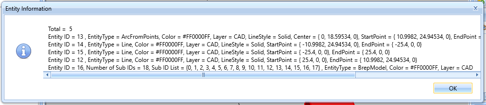

Result:
Example showing the usage to obtain the full entity info:
-- Get the selected entities in the workspace
retTable = Bcc.GetSelectedEntities(false)
-- If there were selected entities
if(retTable ~= nil) then
       local strInfo = "Total =  "..retTable.ArraySize
       local i = 1
       while (retTable[i] ~= nil) do
               strInfo = strInfo.."\nEntity ID = "..retTable[i].ID;
               local subIDs = retTable[i].SubIDs
               if subIDs ~= nil then
                       strInfo = strInfo..", Number of Sub IDs = "..subIDs.ArraySize..", Sub ID List = {"
                       local iSub = 1
                       while subIDs[iSub] ~= nil do
                               if iSub ~= 1 then
                                       strInfo = strInfo..", "
                               end
                               strInfo = strInfo..subIDs[iSub]
                               iSub = iSub + 1
                       end
                       strInfo = strInfo.."}"
               end
               local entData = retTable[i].EntityData
               local strTmp = RecursiveStreamTable(entData)
               if strTmp ~= nil then
                       strInfo = strInfo..strTmp
               end
               i = i + 1
       end
-- Display the message box with the information
       Bcc.ShowMessageBox(strInfo)
else
       Bcc.ShowMessageBox("Nothing Selected!")
end
