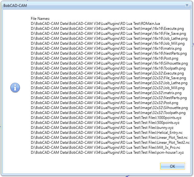

Complete Example
--Loop through the RD Lua Test directory and display a message box with all file names
fileNames = Bcc.GetAllFilesInFolder(Bcc.GetDataFolder().."LuaPlugins\\RD Lua Test", true)
if nil ~= fileNames then
msg = "File Names:\n"
       for i, name in ipairs(fileNames) do
               msg = msg..name.."\n"
       end
       Bcc.ShowMessageBox(msg)
end
