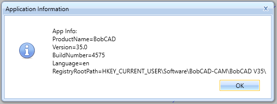

Output from BobCAD-CAM

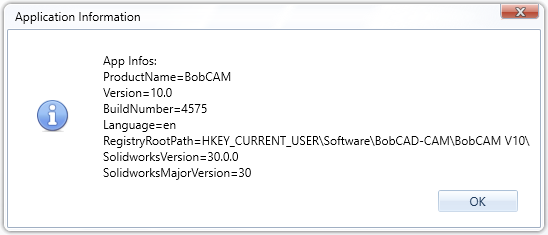

Output from BobCAM for SOLIDWORKS

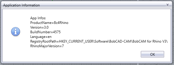

Output from BobCAM for Rhino
