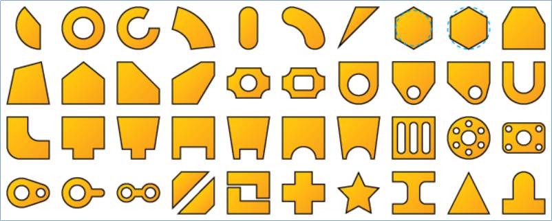

The Shape Library dialog in the Data Entry Manager displays the parameters for one shape at a time. To choose a different shape, click on the diagram of the shape, and the choices will appear as shown in the image below.
Click the shape that you want to create and appropriate parameters display in the Data Entry Manager.
